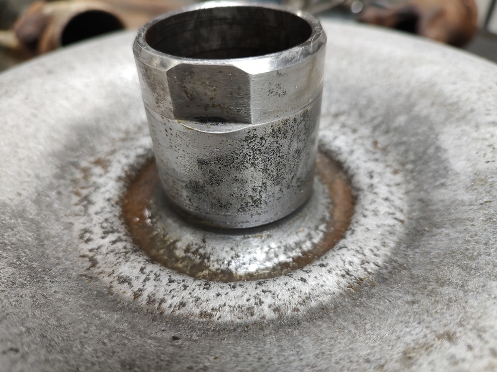

So I am getting really close to installing the engine and trans into my Hertz-G and I have an issue with the original torque convertor. The rust pitting will destroy my new seal pretty quickly.
I believe I can buy a sleeve to put over it. Can’t seem to find the right one… Sending it out for rebuilding would cost $200 ($100 each way) just for shipping. Or maybe I should replace the torque convertor all together?

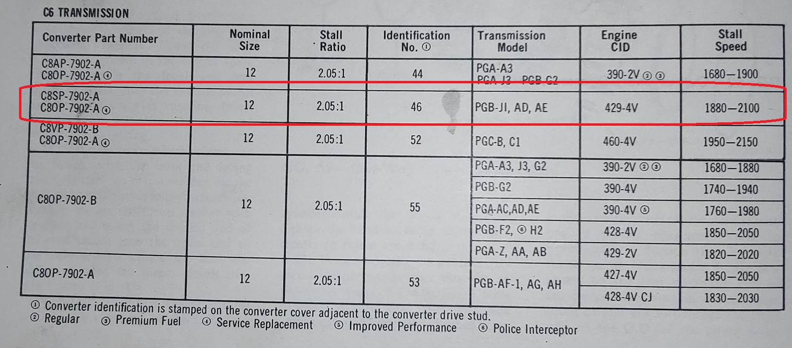

It’s stamped “46” on it, so it’s this one.
Seems like this one is pretty close to it:
C6 Transmission Torque Converter (Non Lockup-31 Spline) 1800-2200 Stall - FM127 - Price Includes Core Charge - Global Transmission Parts
Any suggestions on a stock replacement would be appreciated.
I would replace it with a new one. I’ve had great luck with the Hughes converters from Summit Racing.
Looking at the condition of your convertor, if nothing is done to your transmission, it is probably in need of rebuild as well. If keeping the original convertor is important to you, you can send it out for rebuild. Where are you located?

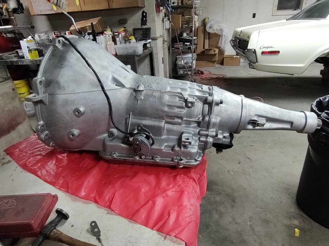

oh yah, I just finished fully rebuilding the trans. Also, made a rear clutch sprag oil mod to get it to oil like the 69+ versions.
I live in Vermont. Probably going with a new torque converter at this point.
