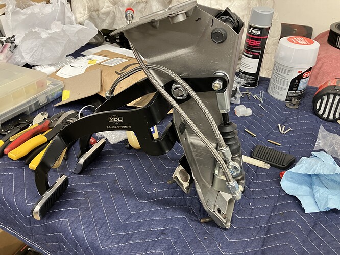

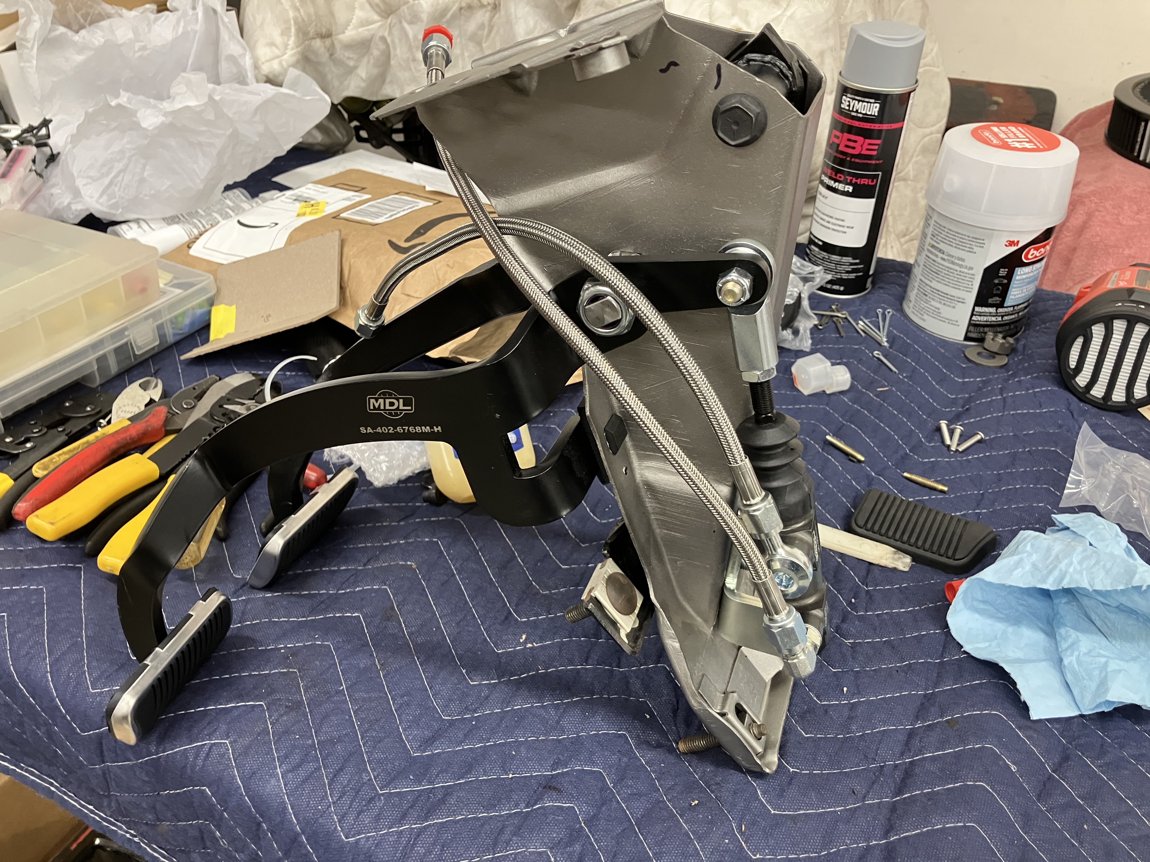

This is the under dash set up I went with. No need for the big cable set up. Hydraulic is the way to go!
https://www.moderndriveline.com/shop/mdl-stealth-series-1967-1968-ford-mustang-in-dash-hydraulic-clutch-master-system/
Oh that’s great to know… that answers my question. So it sounds like all I need is the clutch and brake pedal, and it bolts into the existing bracket… thanks!

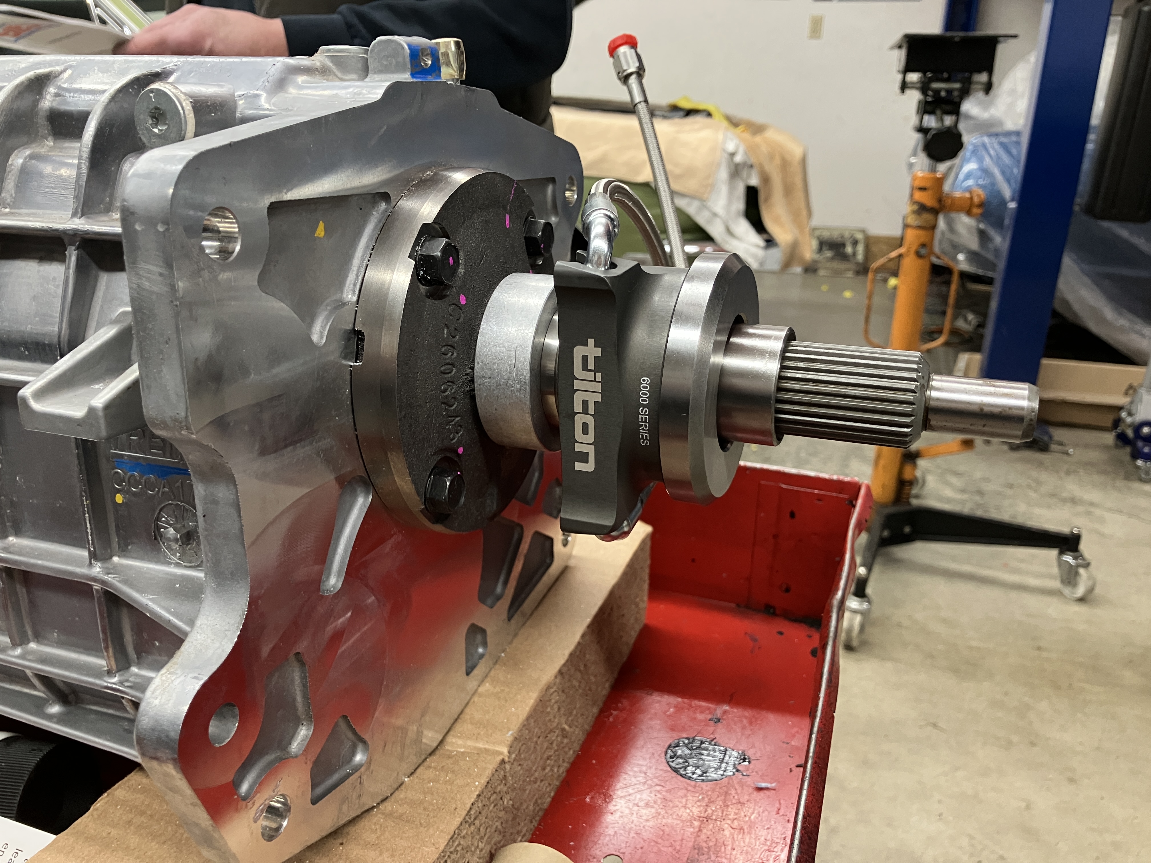

I think my concern is, being really focused on reliability, I wouldn’t want to deal with a hydraulic throw-out bearing. The OEM’s make pretty good TOB’s, that usually last around 100k miles… I guess I’m a little skeptical of aftermarket hyd TOB’s, especially when I can get a Ford TOB for a T-5… but I’m guessing you don’t have any issues with yours so far?
No issues at all! Drove it around all summer. Works like a dream!
Man, thanks so much for the input… I’m now going to stew on this a bit. I’ve driven clutch cable cars a lot, but it’s hard to beat the clutch actuation on a hyd setup…

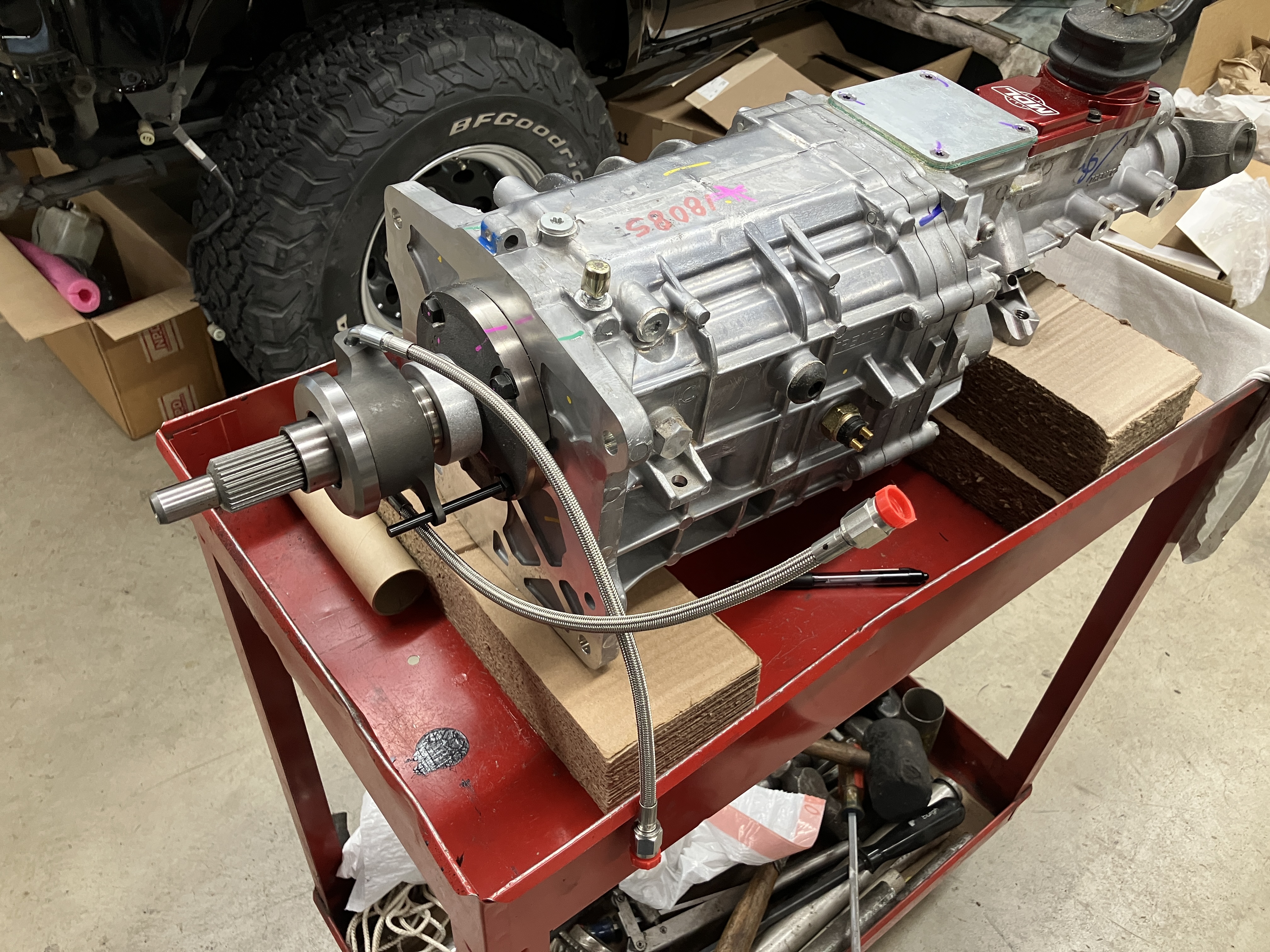

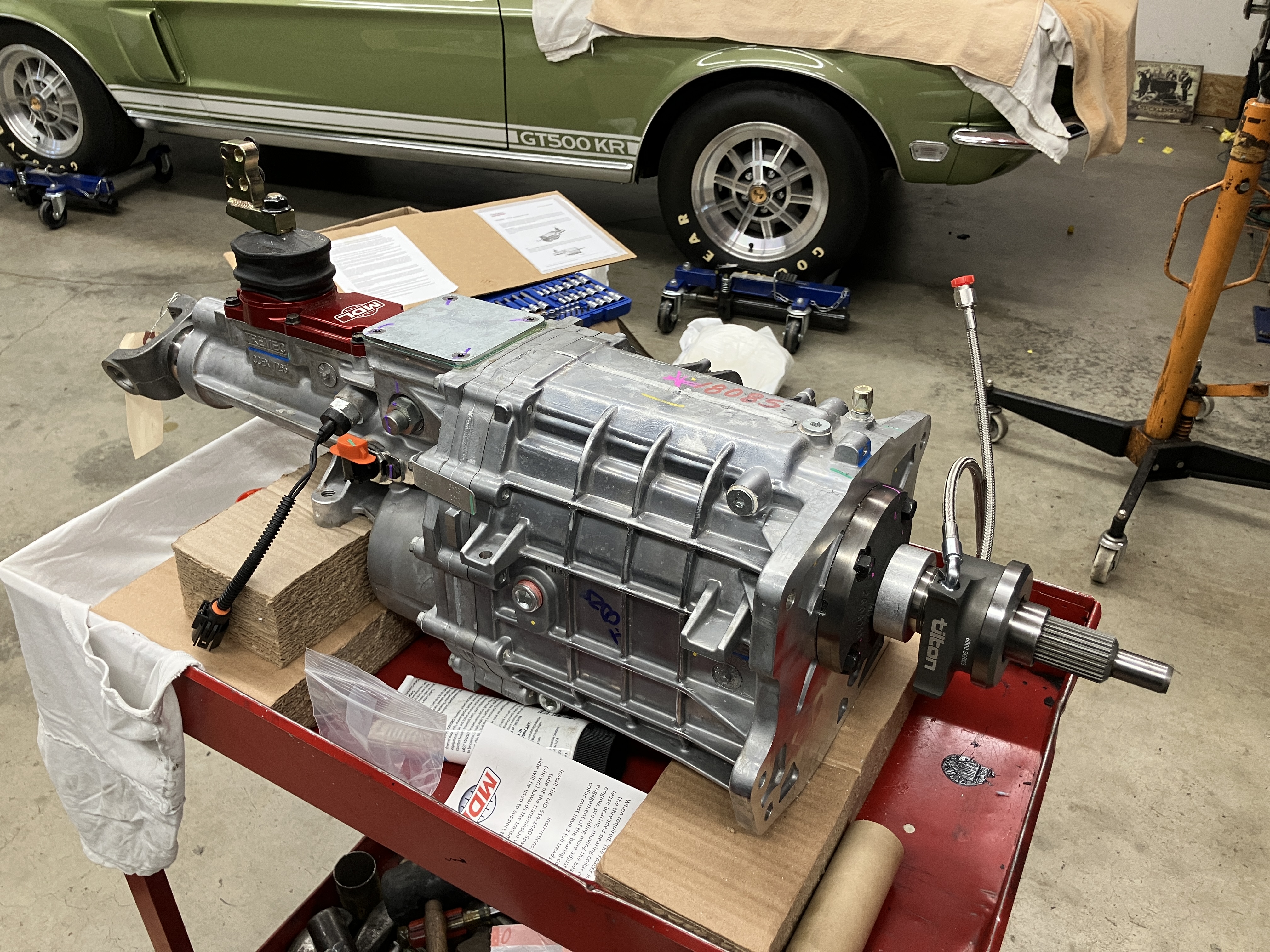

Is that a TKO?
It’s a TKX. :grin:
Is that a GT500 behind the TKX?
Good eye! Yes it was. 1968 GT500 KR actually. 4 speed car with AC! Dad was helping out with some repairs on it.
