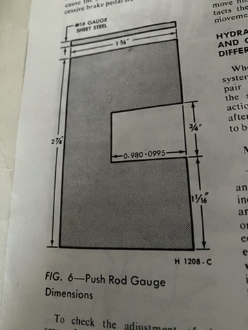

If you have a Ford rod it would be ajustable. From the 68 manuel. page 2-4
D296403C-3649-4FCA-9DD8-F6F348874C7D_4_5005_c
It’s a Midland type repro booster from WCCC & it wasn’t adjustable that I could tell?
I don’t know if this is your problem,but the rod that goes into the rear of master cylinder should be adjustable.
Thanks catlover, yes that’s the issue, I didn’t realize the rod was adjustable. Now I do & can make the adjustment with a tool I purchased on Amazon. I have the Cougar shop manual showing the adjustment info.
