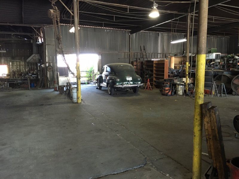

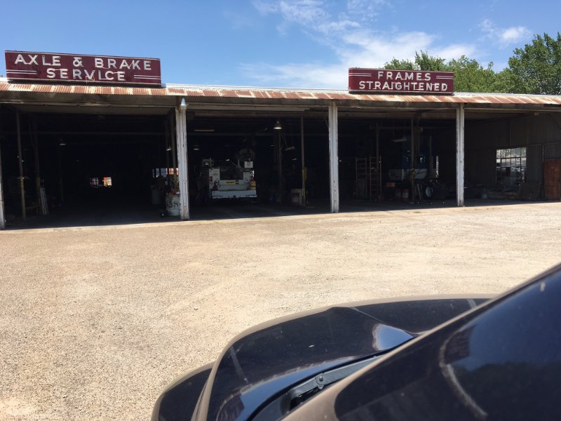

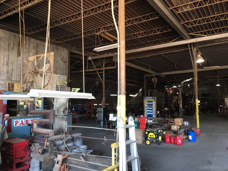

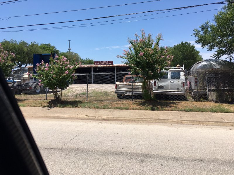

One of my favorite places in Dallas is the leaf spring company Truett Worral. Their street is almost swallowed up by expansion of Parkland Hospital, yet their property looks much the same as it probably did 50 years ago. You can either bring them the springs or the entire car - they just need to know how much to change and which direction.
I took these pictures in 2017. I hope it’s still exactly like this today.
No city of Dallas code inspector would ever sign off on construction like this - it’s really bad!
