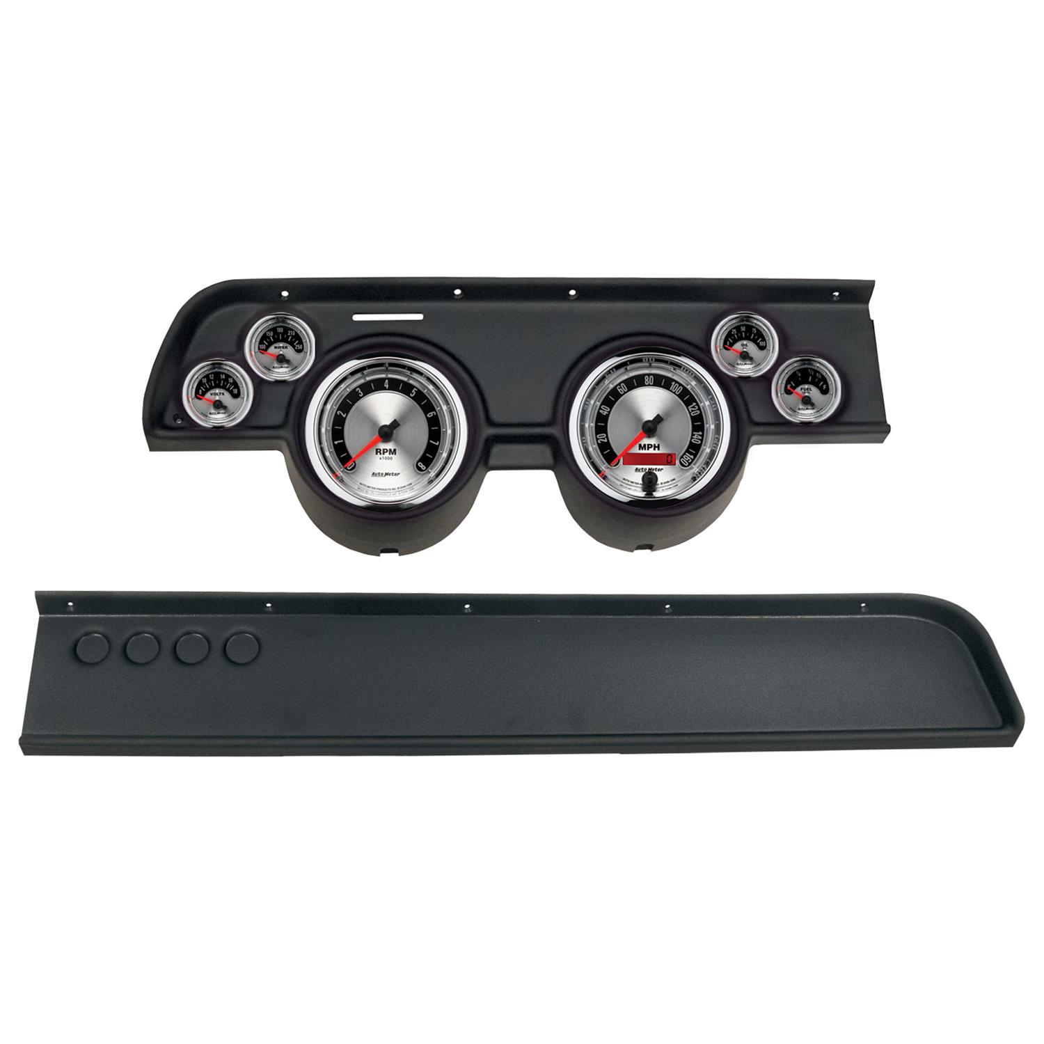

I saw this on Summit and was wondering if it would work on a base model if I only used the drivers side:
https://www.summitracing.com/parts/atm-2114-01
I think it would be better if you use both sides. Just using the one may look odd and you will not be able to use the dash face pad from your original set with the aftermarket one.

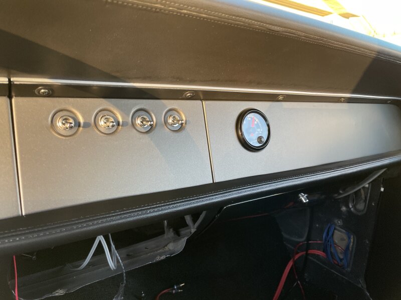

gotta add your own.There are some nice small compact options out there that look pretty good
Guess you could use both sides and just put a round LED in the middle of those indents for the XR7 style switches to use for the turn signal, high beam, brake, etc lamps?
I found turn signal and high beam led’s from a motorcycle aftermarket part supplier. Drilled holes in the bezel and glued them in. They look great!

When you are on the Summit site for this cluster click on the CHECK THE FIT button. It says that it is for a base model Cougar. So you should be good if you go this route. You might also want to check out Dakota Digital for their clusters.

Yes this is the only off the shelf option for cougars that I am aware of. I searched a ton before doing mine. You can get them without the gauges too so you can choose your gauges yourself if desired. Dakota will build you one or modify the original but its very very costly.

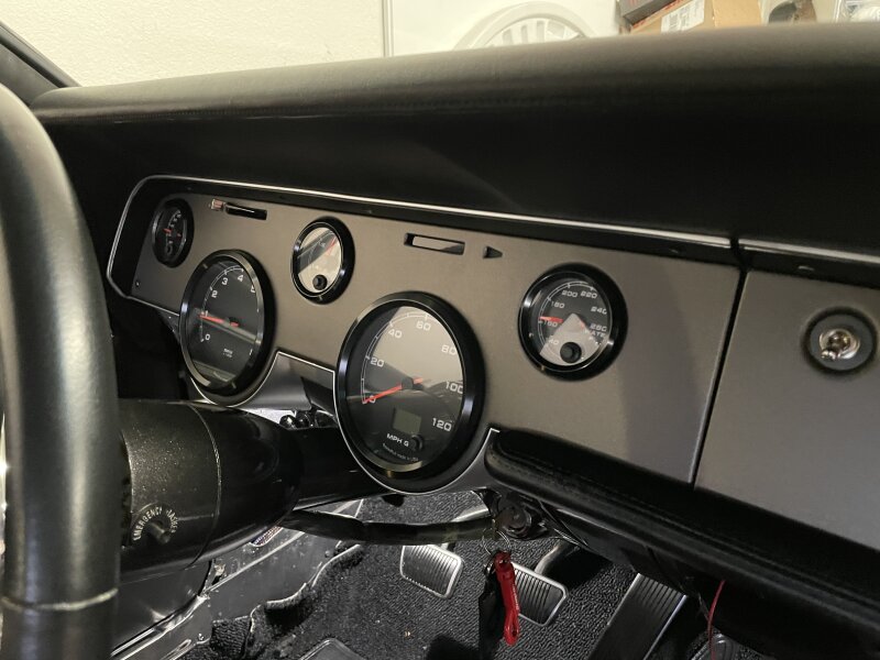

Just as a comparison here is the xr7 cluster I modified with a full set of gauges from speedhut. These gauges have warning light you can program for high/low ranges. Low fuel light, high coolant temp etc. Turn signals retained in original spot. No brake light but if concerned can but installed easy enough. I felt this to be a little better option then the aftermarket pierce as it fits the look I was shooting for but I lucked out finding a cheapish xr7 cluster. Just another idea to consider
