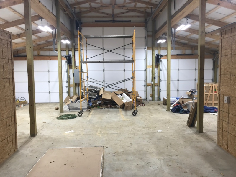

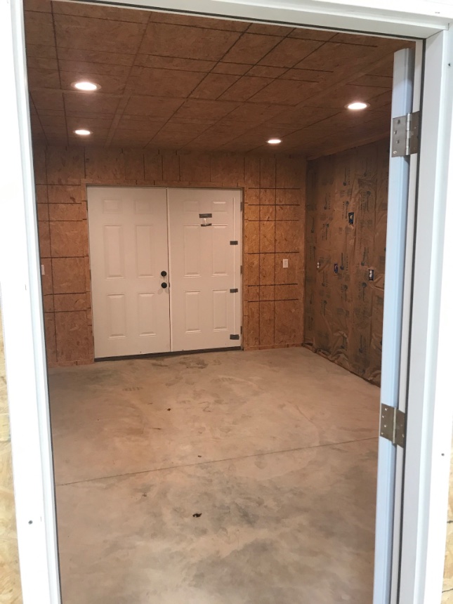

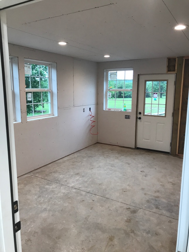

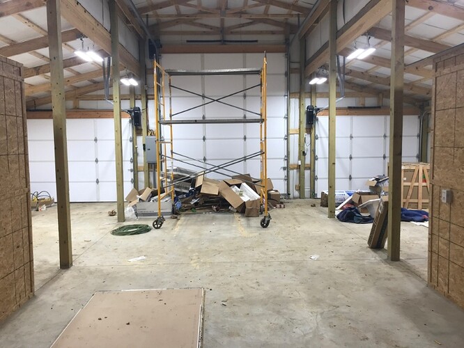

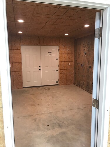

I did snap a couple of photos…
Great photo’s…sounds like your covering all the bases :smoke:
I have been following this thread as well. I have had a couple of larger and detached garages and can say that everything I would and want has been mentioned. AC/Water/220V/ Insulated and LOTS of Storage area to organize projects and parts.
The photos show a great looking shop!!!
