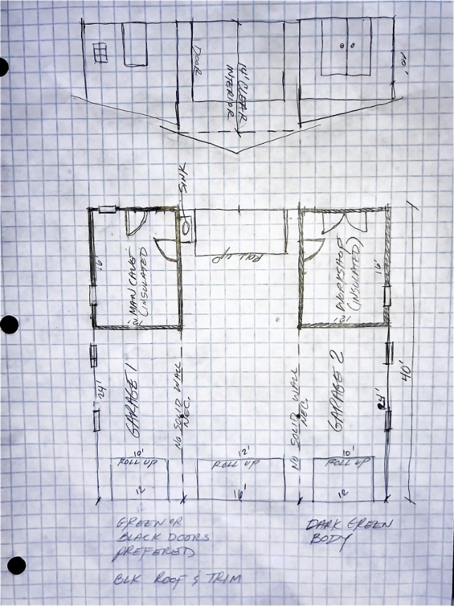

Hi y’all! Not sure if I’m in the right sub or not, but here goes. I recently retired and bought a place without a garage, so we built one. I’ve never thought about planning out a workspace, since I was squeezed into a single space before, and there wasn’t much room anyway. I just kinda…functioned.
It’s a 40’x40’ pole barn with 2-12’x16’ workrooms, and a tall center section to accommodate a lift. It’s insulated, wired for 220, and the floor is 12” thick between the rooms, where the lift will go. I’m hoping to get some thoughts on what tools and general stuff you’ve found to be a “must-have” and where would you put stuff (toolboxes, workbench, compressors, parts cleaners, etc). Basically just doing regular maintenance and repair, not rotisserie restoration or anything like that. I probably have alot of the stuff already, but as long as I’m starting from scratch, some pro-tips would be good! Thanks!!

Insulate the hell out of it. Where it says roll up doors change that to overhead door, basically sectional garage doors that can be insulated. Roll up doors can’t really be insulated. You can’t go wrong with more insulation.
Epoxy the floors. Hire someone that does the real deal two part epoxy.
Install heat and AC. Nothing is more expensive than a building you can’t use.
Install LED lighting. Install a lot more than you think you will need. Consider installing lighting on the side walls to illuminate the interior of the car you are working on.
Run air lines all around the building. Put the Compressor in a closet so you don’t have to hear the thing.
Install 230 out lets all around the building.
Build lots of work surface. That means line every wall with base cabinets. Install uppers leaving a clear workspace underneath. Install LED lighting under the uppers. Build large island benches for the middle of the work space. Buy a big vice and anchor to one of these.

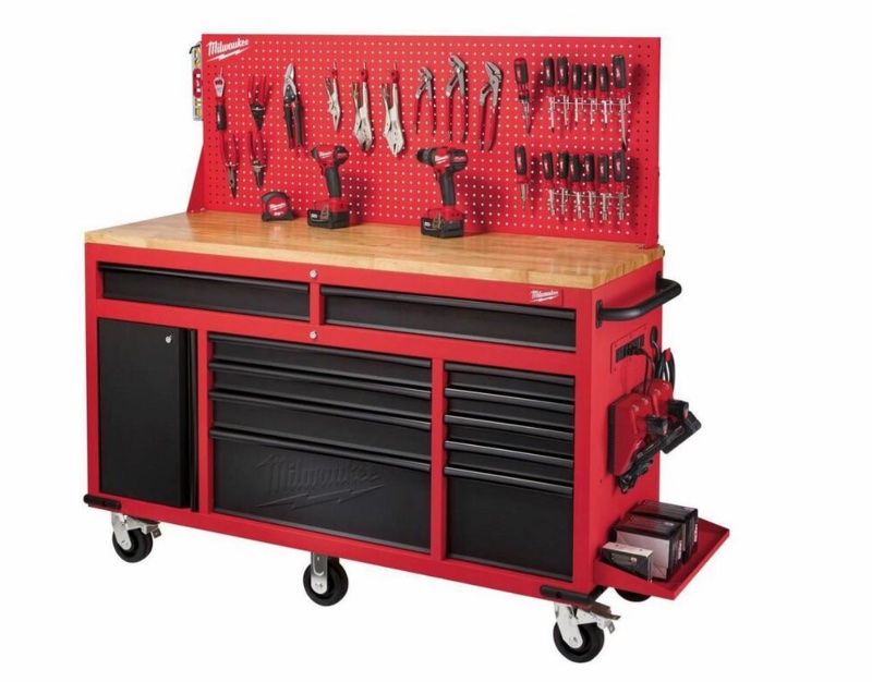

All good stuff. Center space is 16’ wide, so plenty of room for the lift between cabs on each side. Planning to start there and expand. What do you think about a rolling bench with drawers for most often used tools. Kinda like this:
