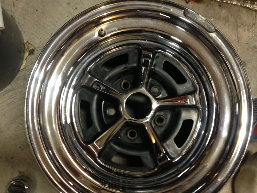

I did an even trade yesterday, my wheels and tires I had (15x8.5, 15x10 torq thrusts bad tires) for a set of magnum 500s. 15x7 front and 15x8 rear. I really wanted 15x7’s on all 4s but the 8’s will do. I want the car to look more level and “stockish” and have been looking at 235/60/15 or 215/65/15 for the front and 245/60/15’s for the rear.
Im fairly confident that the 235’s up front will work/look fine. But Im also considering a narrower 215/65 tire for the front or even a 225. I want no rubbing issues and I would like to keep the 26" tall tire the same front and rear. Right now im leaning on the 215/65’s front and 245/60 rears.
Anyone esle running a 215/65 up front? Any rubbing issues?
Here is what I got for trade pretty good shape, almost perfect, will add a new coat of black to the windows and probably get the black cougar caps. These are steelies but have the aluminum american racing caps with it. The wheels are standard backspace, 4.25 up front 4.5 in the rear.
Need to get tires soon! not sure how much the neighbors will like this…The coog looks kinda sad, but anxious for new shoes. I dont know I kinda like the steelies!
