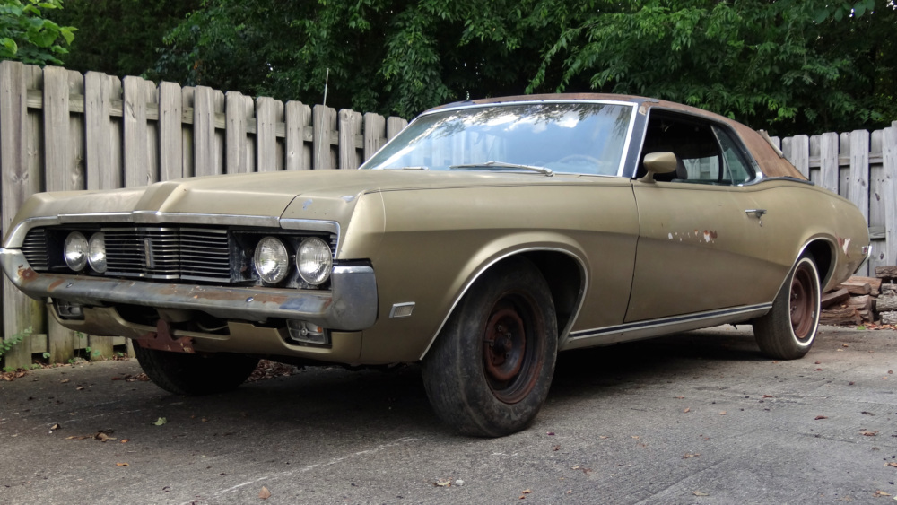

Hi everyone…I recently bought a 69 std 351w 2bbl from a buddy (second owner) who hasn’t driven the car for about 20 years. Its in decent shape with only 81k miles. Completely virgin sheet metal with no accidents or rust problems. I just finished rebuilding the brakes so i can take it out to evaluate the drive train. So far I’m leaning towards an Eliminator clone. I just recently moved to the Birmingham, Al area and don’t have any car buddies here so…any one who would like to help me get familiar with the shops and stuff around here; give me a message.

A couple days ago I tried to start the Cougar after 18yrs sitting, however I discovered that the gas tank was gummed up and had a huge hole in the corner. Next day I tried rigging up a temp fuel tank just to get it fired and see if the engine and trans are in good order. Next I found that the fuel line as well as the carb was gunked up completely. So, after several cans of carb cleaner and a rebuild kit it finally started and continued to run! Even better yet…the headlight doors CLOSED! I’m assuming that the check valve needs replacing. Anyway, I drove it down the street and back and it ran just fine and shifted into all gears and reverse. Now I can pull the engine and trans knowing that much. I have a video of it and a website with more. IM SO PUMPED UP! http://cougarrestoration.weebly.com/

Very nice…from the pics it looks like a pretty complete car with most, if not all, the trim. The trim can get pricey if you dont have it.
(Wheel well trim, front hood trim and especially the vinyl top trim) Looks like you only have a few minor dings in the trim and it needs a good buffing to be really nice.
