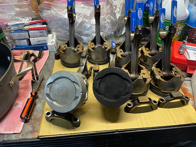

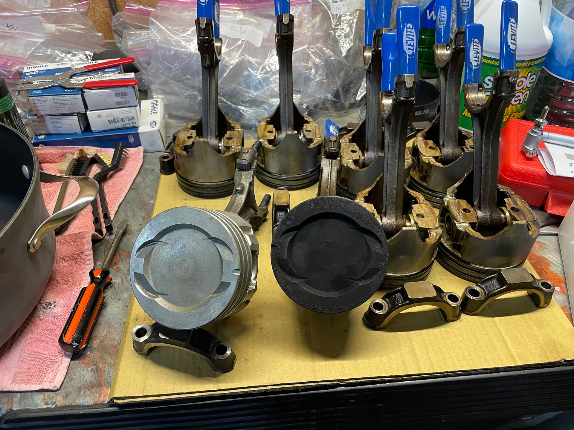

As always, thank you Royce. Now that I know they will go back in I started the cleanup. 1 down, 7 to go.
