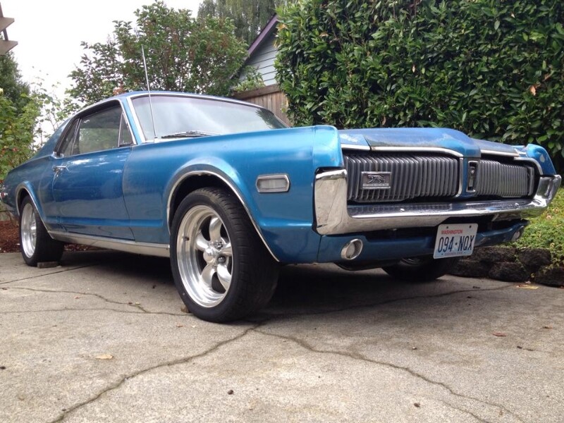

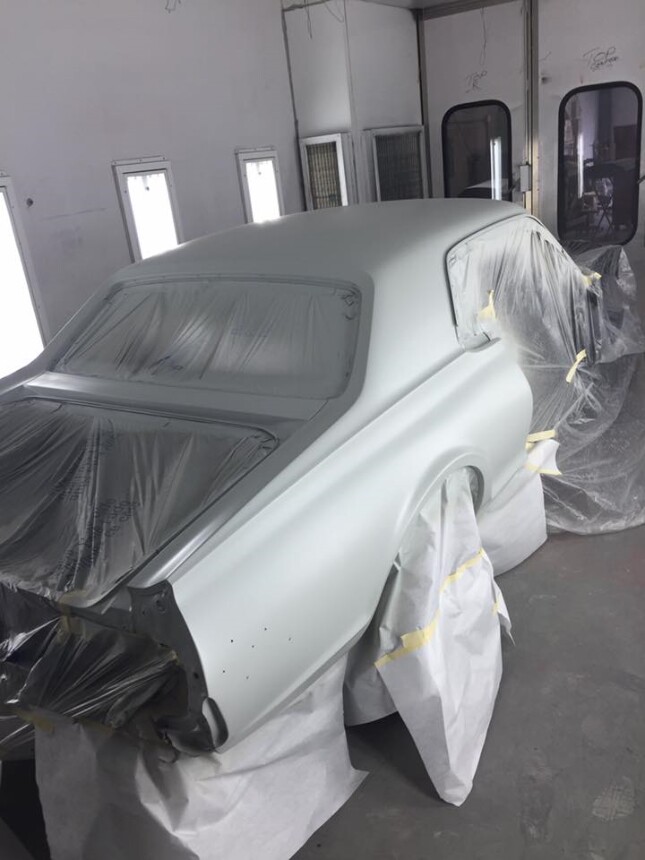

I am in the middle of restoring my 1968 cougar that I’ve had for 20+ years. I picked up several “new to me” pieces from West Coast Classic Cougar including a complete rear quarter, trunk lid, passenger door, and front fender. All of those pieces are installed and nearly ready for final paint. I’d like to find out the proper way to paint the underside of the car. I’ve heard some cars were painted orange underneath and others were black and yet others were body colored. I’ve also heard some of that varies depending on which plant the car was built in. The engine bay was black but I’m not sure what gloss level I should go with.
Attached is a picture of my car before the restoration and one of it with all the metal work done just after the first primer coat.
