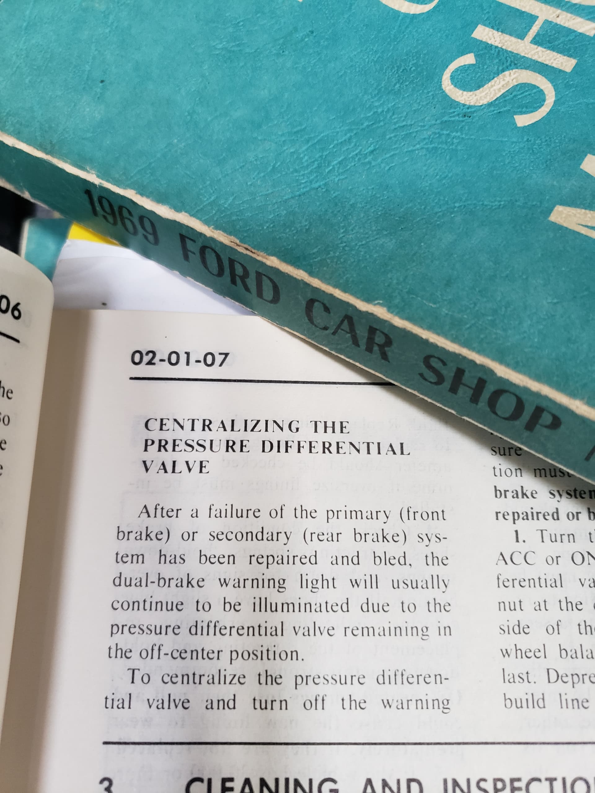

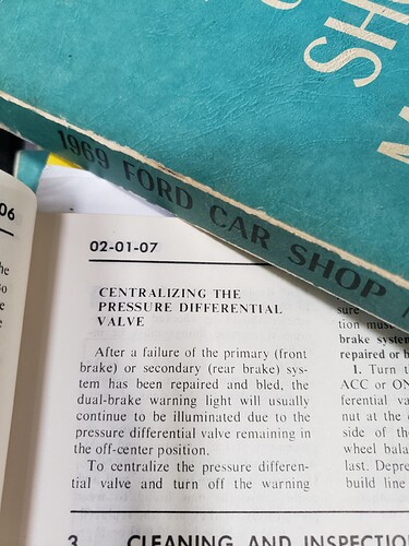

There is no such component installed. What exactly is a ā€œdifferential pressure switch?ā€
Take a look at the factory shop manual. It has what your looking for…
That says ā€œPressure Differential Valveā€. The warning light has no effect on anything except to turn the lamp on and off.
Ford refers to it as the ā€œPressure Differential Valveā€. It actually performs two functions, one being to block off the circuit with the leak, the other being that when the valve moves off center it turns on the light.
You are confused. It only turns on the idiot lamp.
