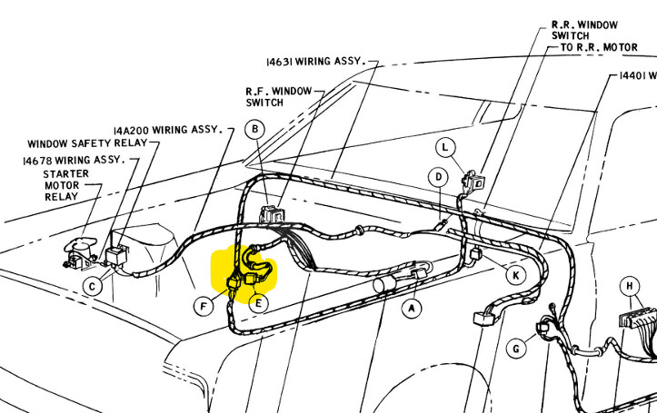

This is on 1969 XR7. I do not have power coming across from the driver side to my passenger side power windows. I believe the Red/Blue Stripe (170) carries power to the switches. The harness junction on the passenger side of the dash had a couple Bullet/Plug connections that I was uncertain about correct connections. Is this where my error is located? Windows on passenger side work fine if I bring in my own power. Looks like my dash is coming off. Again! :frowning:

Might be the connectors. I think you can swap them and break the circuit.

There were I believe three bullet/plug combos that were hard to match due to faded wire color. I think only one applied to my car - I think the other two were for a convertible top and rear defroster. Just not sure if I made the right connection. And it may have nothing to do with PW. Could I have made an error on the (E) and (F) connector as you suggested? Cannot remember if it was possible and it seems other devices would not be working but everything else is. I will look to see if I can access the connectors with the glove box out.
