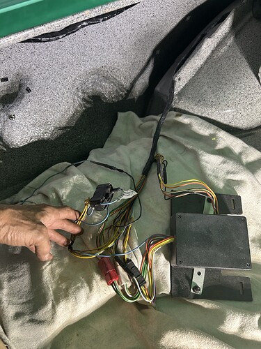

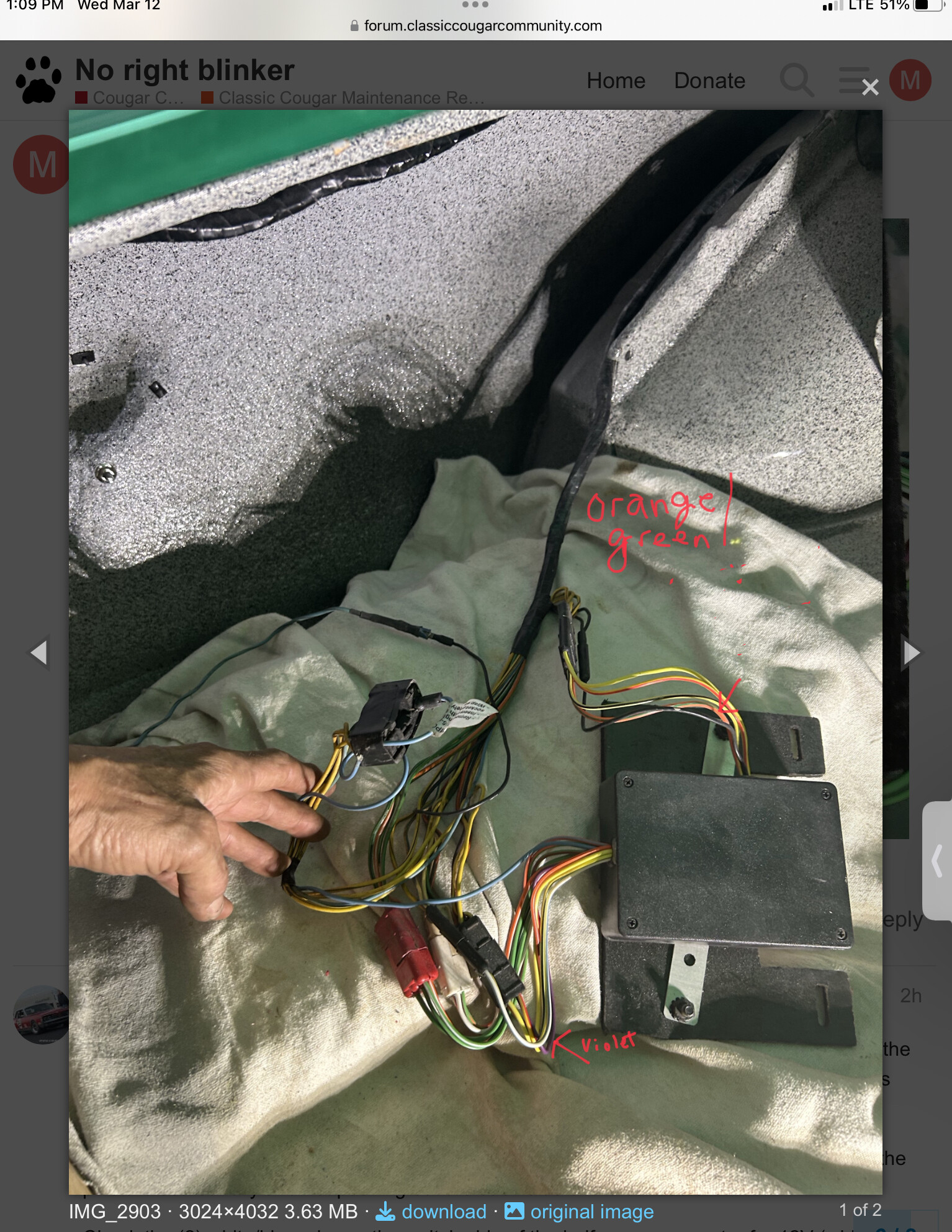

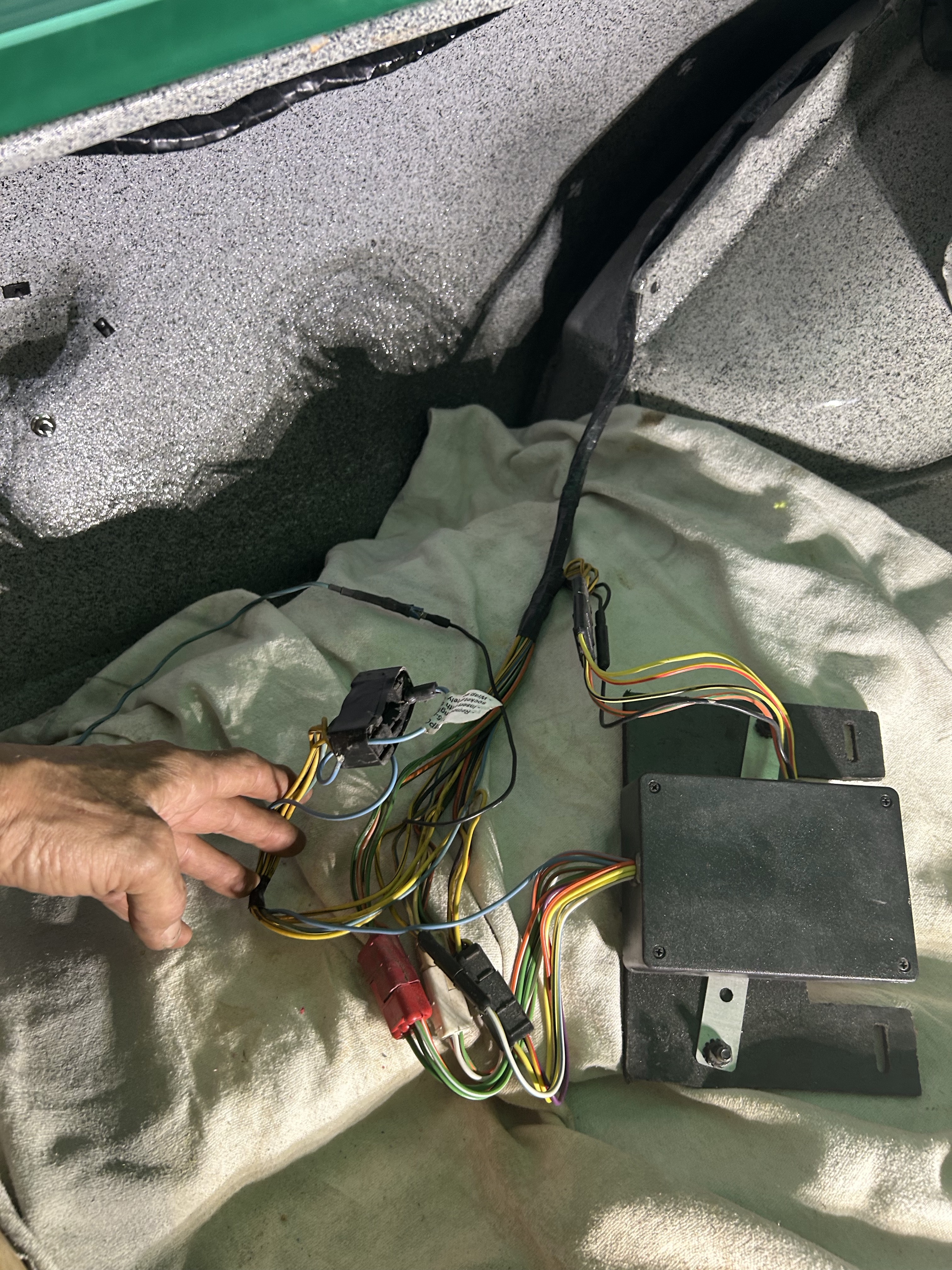

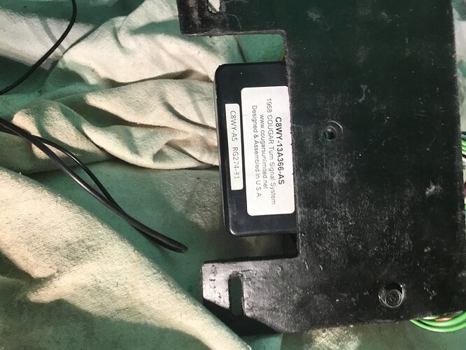

First, with the turn signal lever in the right position, check the orange/green stripe wire entering the control unit in the trunk for 12V power.
Then check the violet wire.
Ok yes I have power on the orange cable with the green stripe, but no power on the purple wire

The problem is the missing 12V signal on the (441) violet wire. It tells the controller to flash the RH turn signal. The problem is either in the wire/connectors along the circuitous path for this wire or the turn signal switch.
First try plugging/unplugging the 10-pin half-moon turn signal switch connector. Make sure the pins are seated fully and not pushing out the back-side of the connector.
Check the (2) white/blue wire on the switch side of the half-moon connector for 12V (while plugged in). If this power is missing, the switch may be bad. You can usually stick a thin test light probe alongside the wire from the backside of the connector down to the metal pin.
Then check the matching violet wire on the car harness side of the turn signal switch connector. If it has 12V power, the problem is in either the 2-pin connector at the LH rear wheelhouse, the 3-pin connector above the RH kick panel or in the wire path. This wire is in the RH taillight harness that travels across under the rear deck, over the RH wheelhouse, under the RH door sill to the RH front kick panel and plugs into the main under-dash harness.

This is the correct violet wire ??
The violet wire marked at the bottom of the picture is correct.
