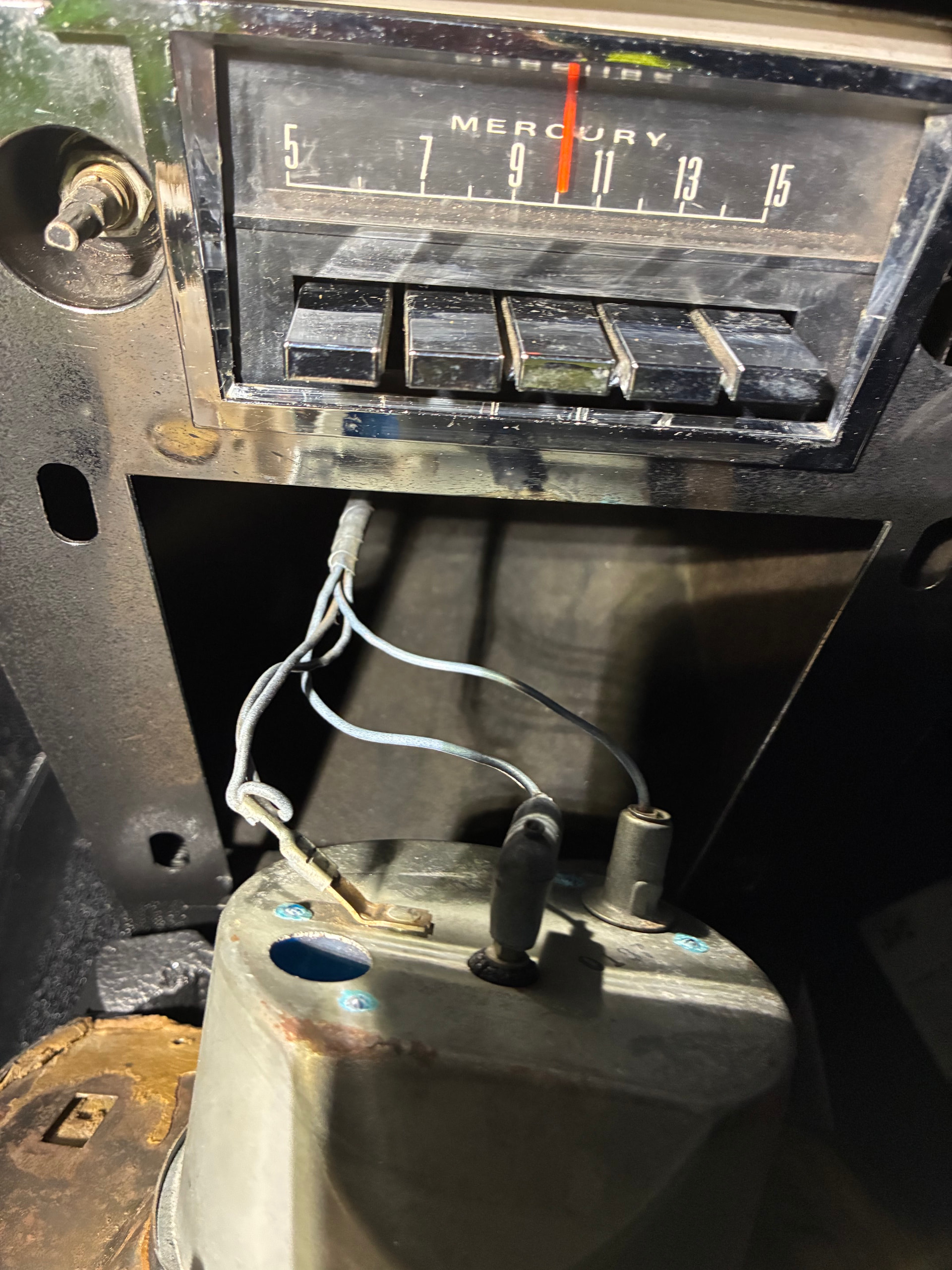

Finishing putting together my 67xr7 interior and notice I only have one light socket for the clock but the housing has two sockets. Is this common? Can I splice on another light? From the research I’ve done seems like there should be two lights. Has anyone ever seen this before
Any evidence of cut wires? Yes, almost every clock harness I’ve seen has two bulbs.
No evidence of cut wires. Going to remove the pad and take some pictures
Any chance it’s a standard harness instead of XR 7? If my memory is right the standard pigtail only had one light for the storage compartment in the console.
Sounds like a standard console pigtail. The power wire for the clock and the ground for the clock are also missing if it is the standard wiring harness.
Having a problem getting the picture to copy
Here’s the picture
