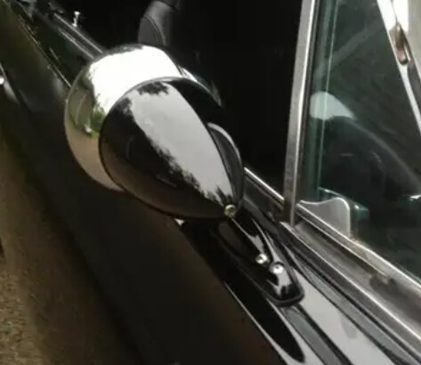

Did the mirror look like this XR7-G mirror?

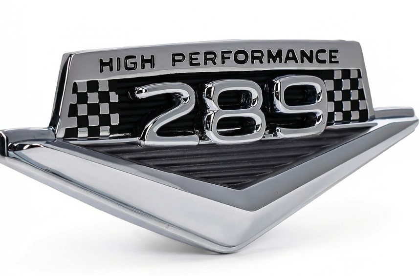

Did the emblem look like this 289 Hi Perf badge? I believe they were only on K code Mustangs and some Falcons?
Yes, the mirror looked similar but the base had a separate “adaptor” base. So there were four screws to mount the mirror. Looked pretty weird. Like this, but I guess that’s how the XR7-G mounted them.
As for the emblem, no, it was just a square plaque looking one maybe 3”x2’“. It didn’t look right being placed there.
There were never any 289 HP Cougars and Kevin Marti would know - there were none. The guy has a fake Cougar. The mirror is another thing that he can’t prove.
