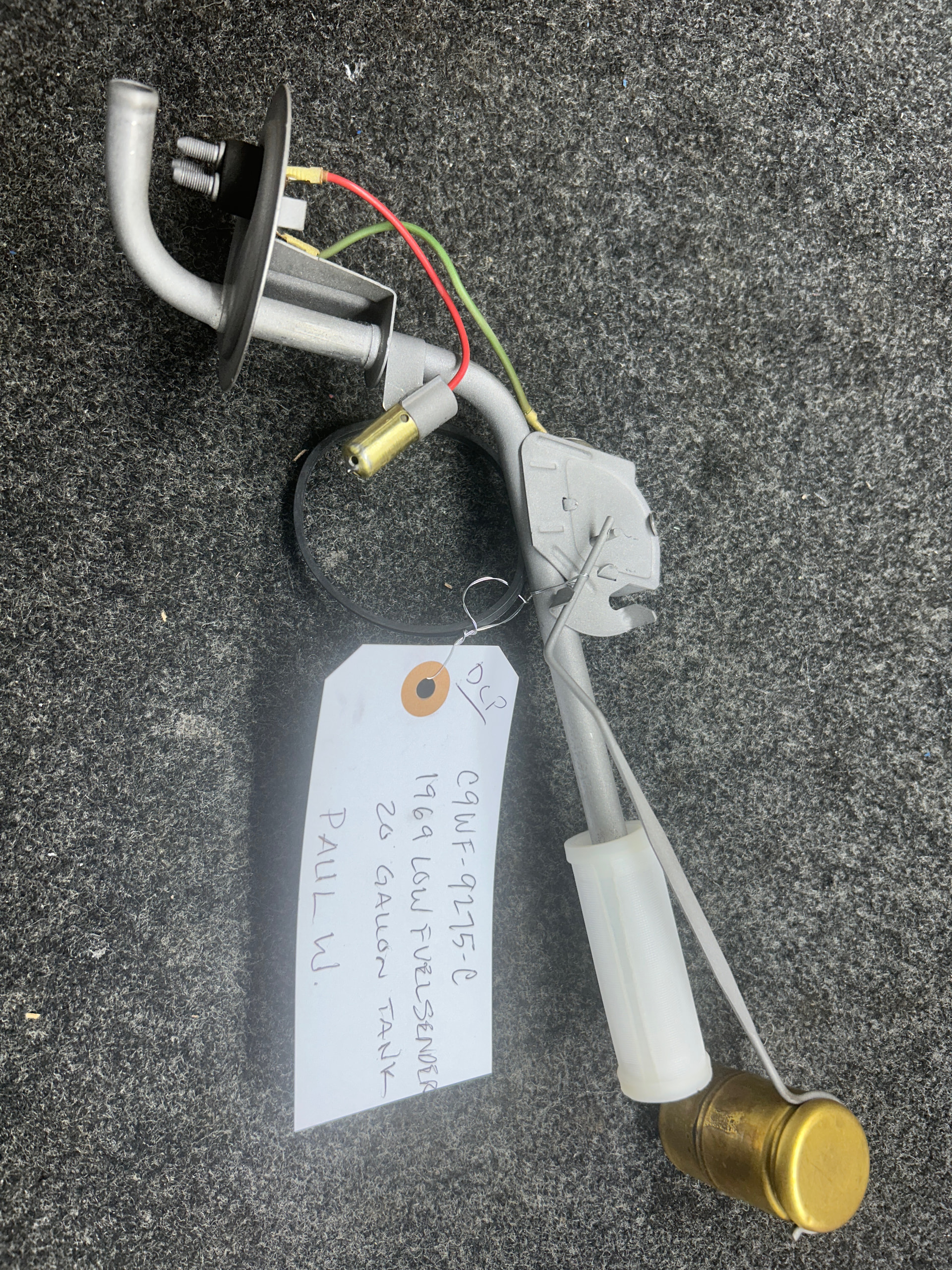

I am looking for OEM Ford fuel sender cores for rebuild and also for parts. They are worth a minimum of $20. I need a picture of the sender with the date and your name. Way too many scammers. Let’s get those parked parts back in circulation. Send me a private message if you would rather text me the picture.
I have a few. I’ll get them packaged up and sent out soon.

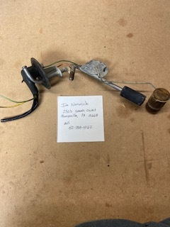

I have my old one I can send you.

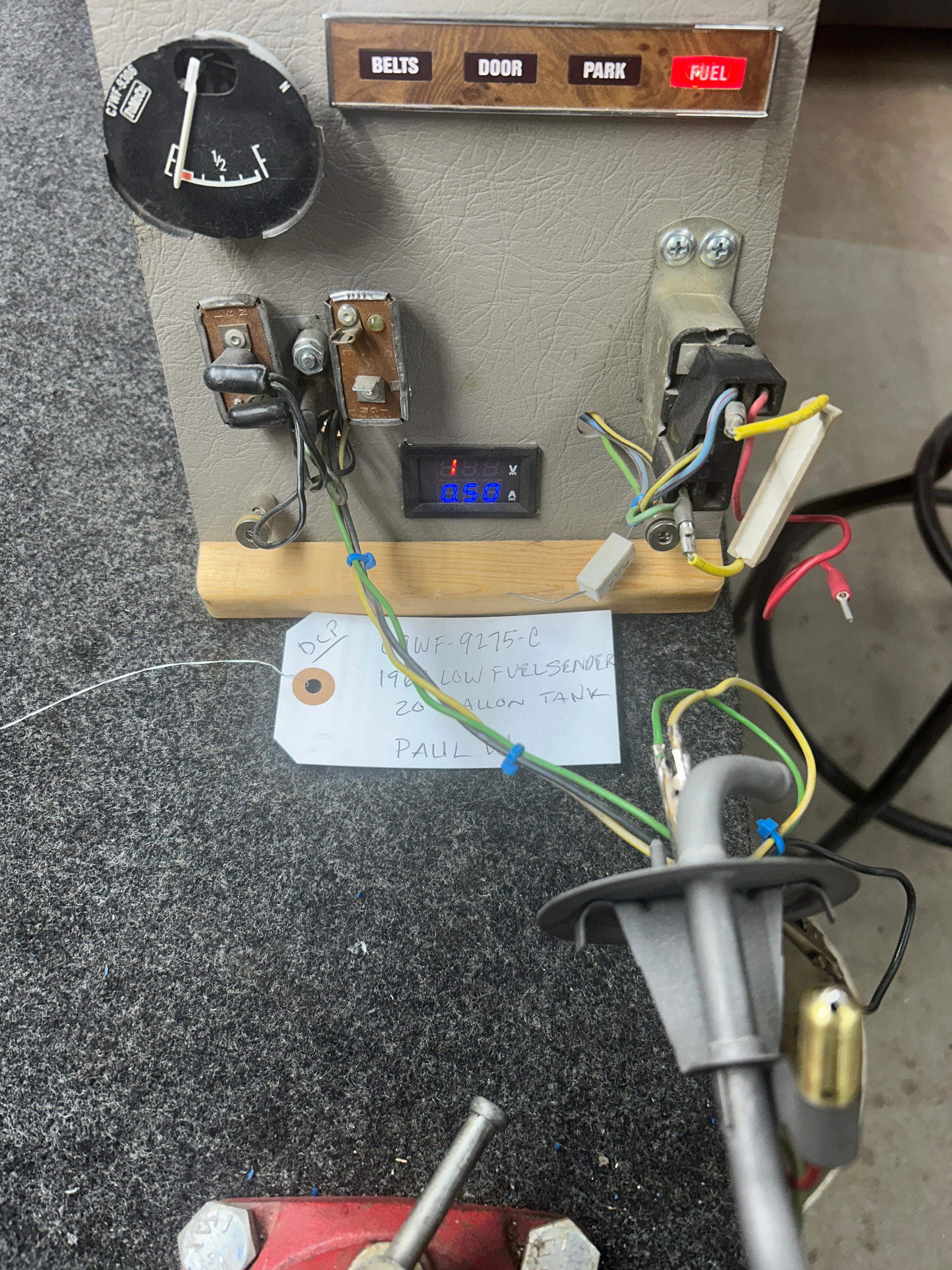

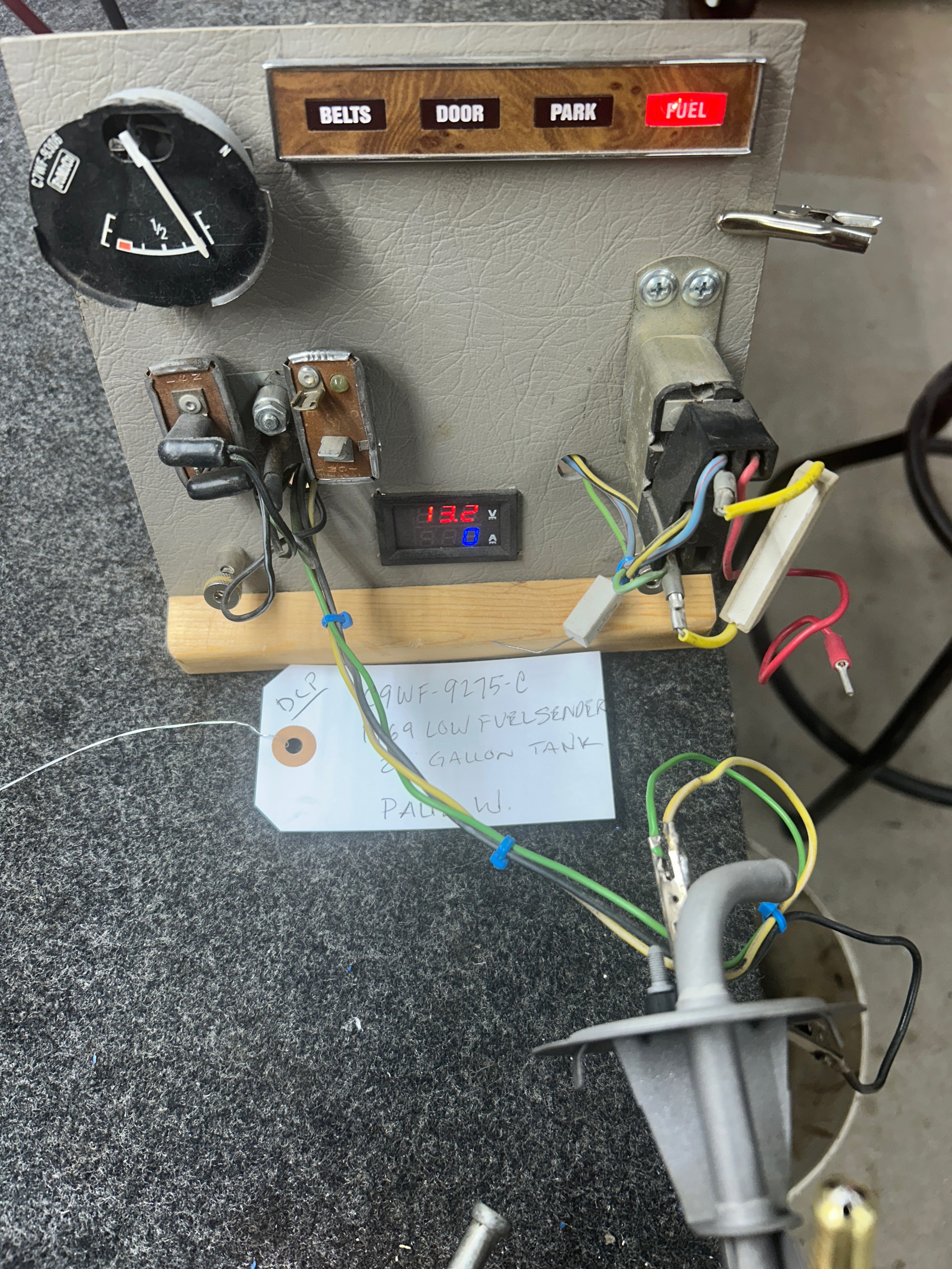

I have your gauge tester, and I can pull apart the dash, but I am hoping I don’t have to.
Unplug the wires to the sender at the tank and clip your gauge tester to the contacts to verify the gauge works properly. It probably will, and that will prove that your sender is the problem.
Exactly correct!
And in retrospect, obvious. Poles on the back of the gauge or the ends of the lines…same. I knew it was going to be a silly question!
