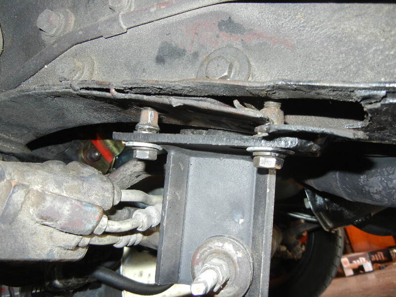

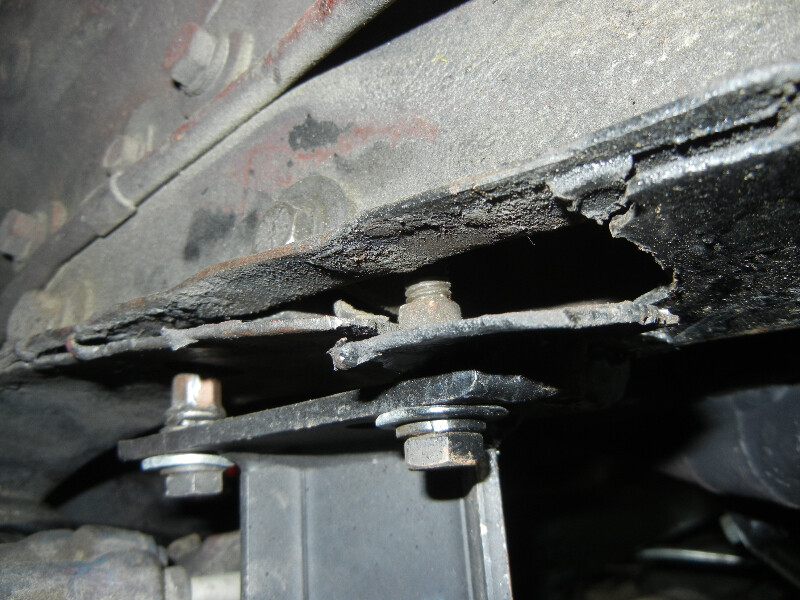

I need some advice, last year I put Hooker long tubes on my cat and per the instructions I added a power steering lower bracket. This past weekend I noticed a clicking noise while turning left and found the following (see pic), it seems that the addition of the larger tires and the angle at which the ram is now positioned because of the lowering bracket has caused too much stress on the frame rail pulling the frame nuts through and peeling the frame rail metal apart. I am looking at doing a Borgeson conversion to eliminate the ram, can anyone give me some insight on this conversion with respect to the tilt away column, any fitment issues, quality of the product, ease of installation or any tips. I think repairing what I have is not the best option?

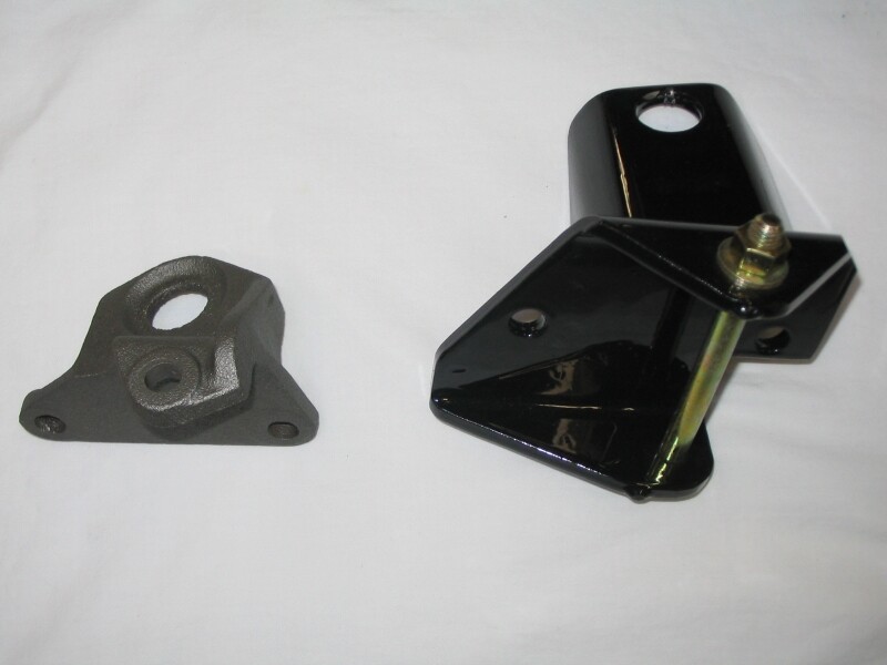

If it were me, I would get a welding shop to repair the damage and then I would buy one of the bullet-proof brackets that CANNOT pull out (due to it’s design) from WCCC and put it on. This is what I run. If you go the route I am suggesting, you need to make sure the shop repairs the nutserts too (they could just weld regular nuts on the inside which is currently exposed if the current nutserts are not serviceable). Here’s a (blurry!) picture of mine/what I’m talking about:

The Hooker instructions clearly state that the bracket must be welded in place. You didn’'t follow the directions, and the predictable result happened. Been there, done that, got the T shirt. A competent welder can fix it in an afternoon.
A lousy solution but one that takes some of the stress off the nutserts at least (which is why it works). The WCCC bracket is the only way to fly which doesn’t permanently append a crappy bracket to your car.

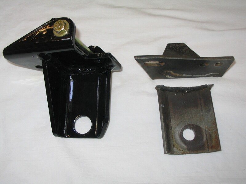

That bracket is an amazing piece. Designed by a engineer friend & Cougar nut. This can’t tear out of the frame like the ones provided in some header kits. DON"T use them, toss in recycle pile.
As you can see it is a major improvement, but a ding to the pocket book.
Based on damage, maybe the bracket is cheaper?

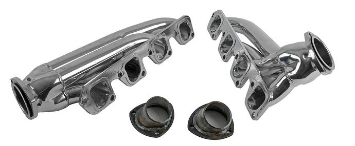

Sanderson makes a reasonably priced set of 351C shortys:

For the benefit of those who are building something that they want to be the best it can be and save 4" or more ground clearance the shortys are the way to go.
