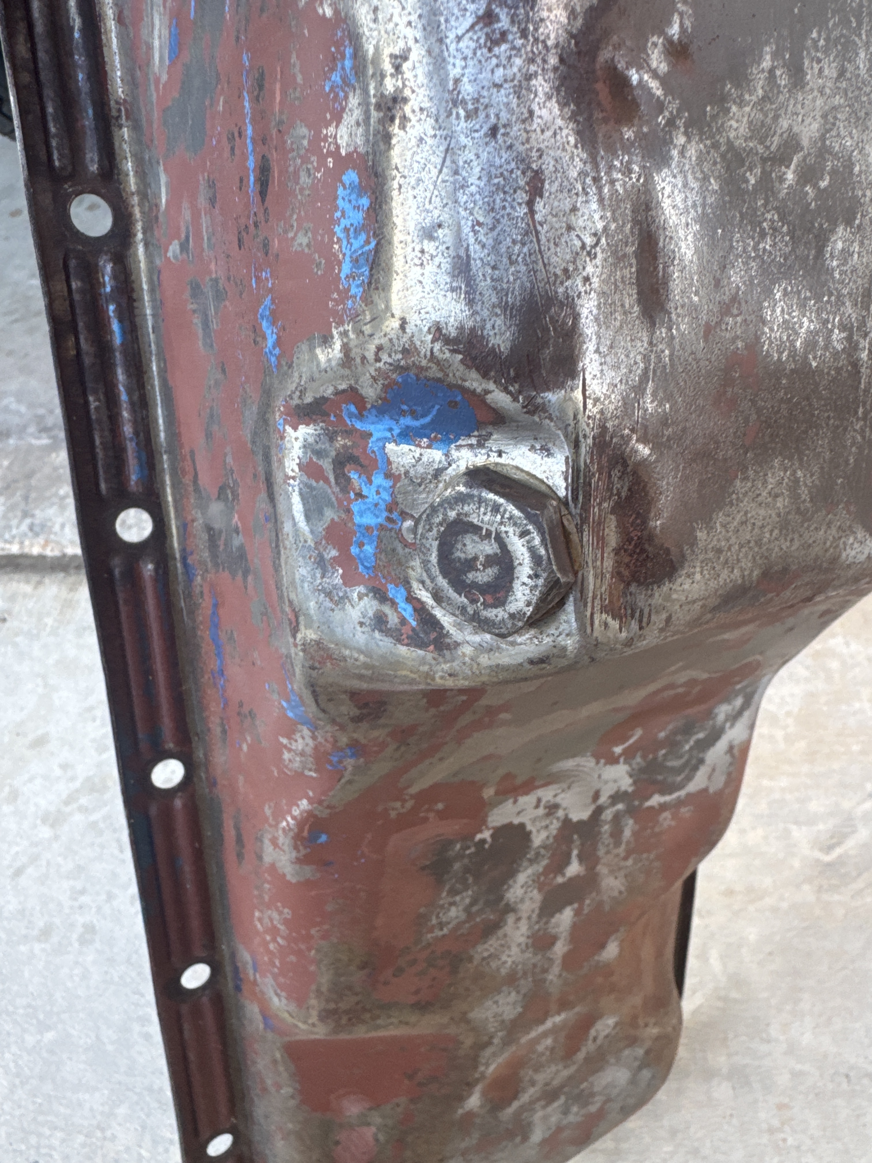

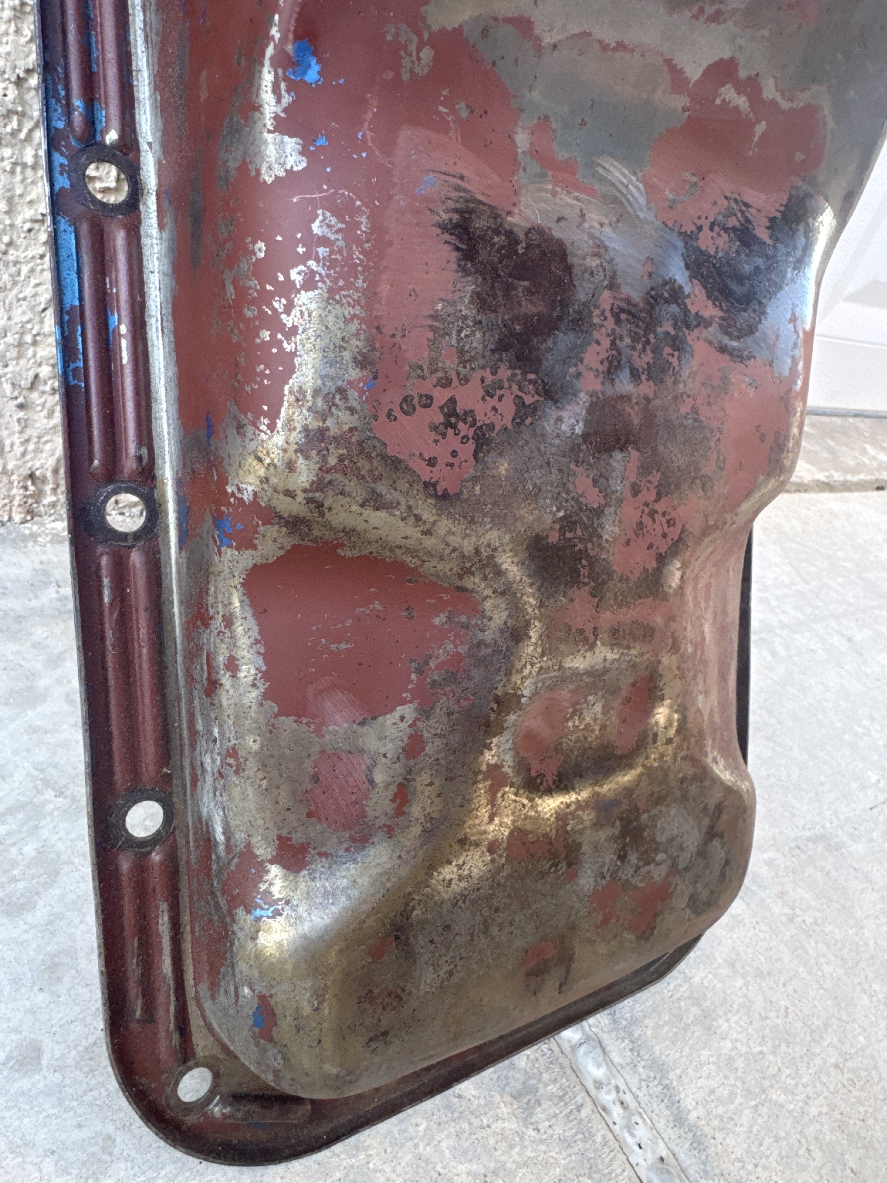

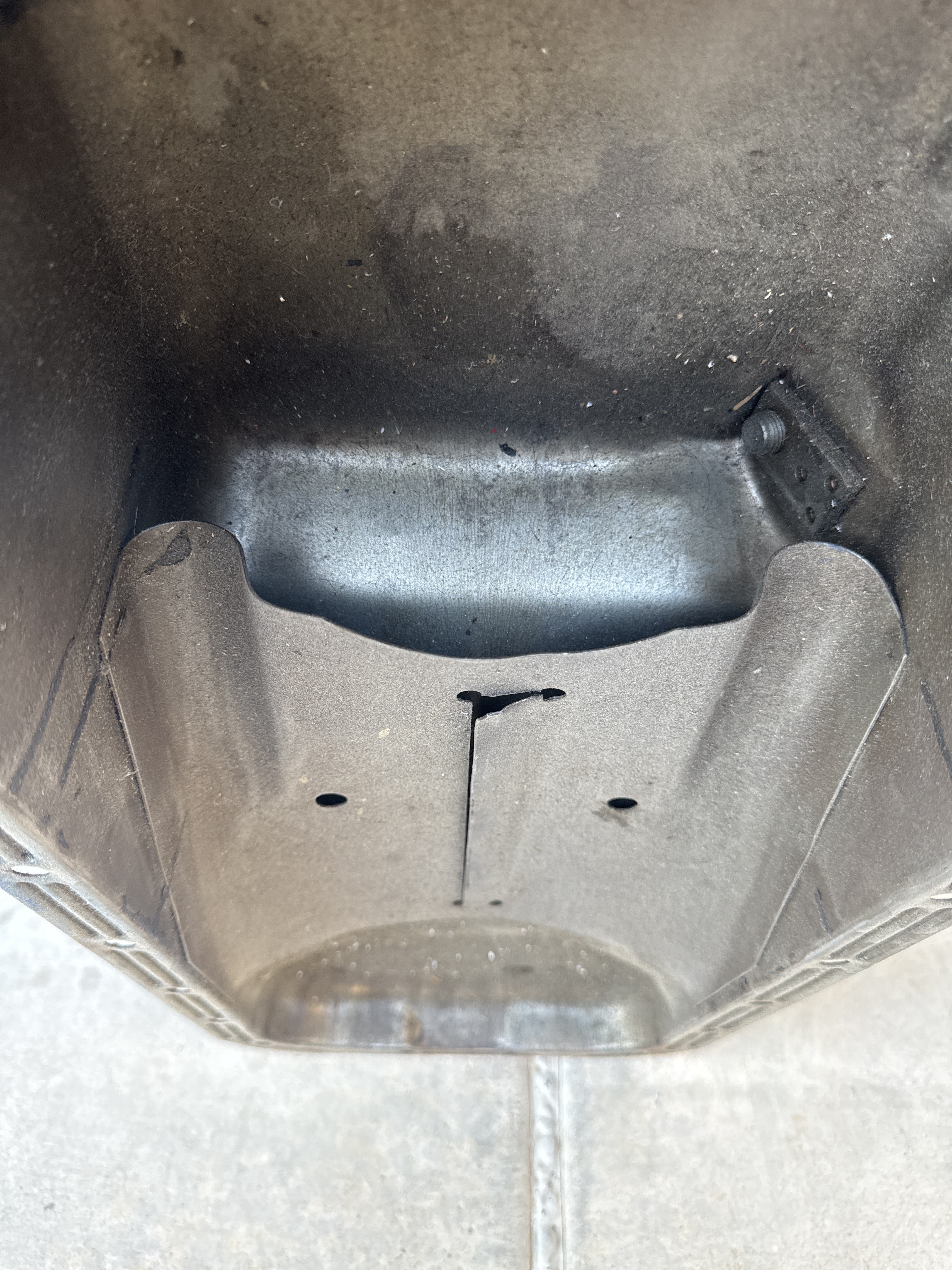

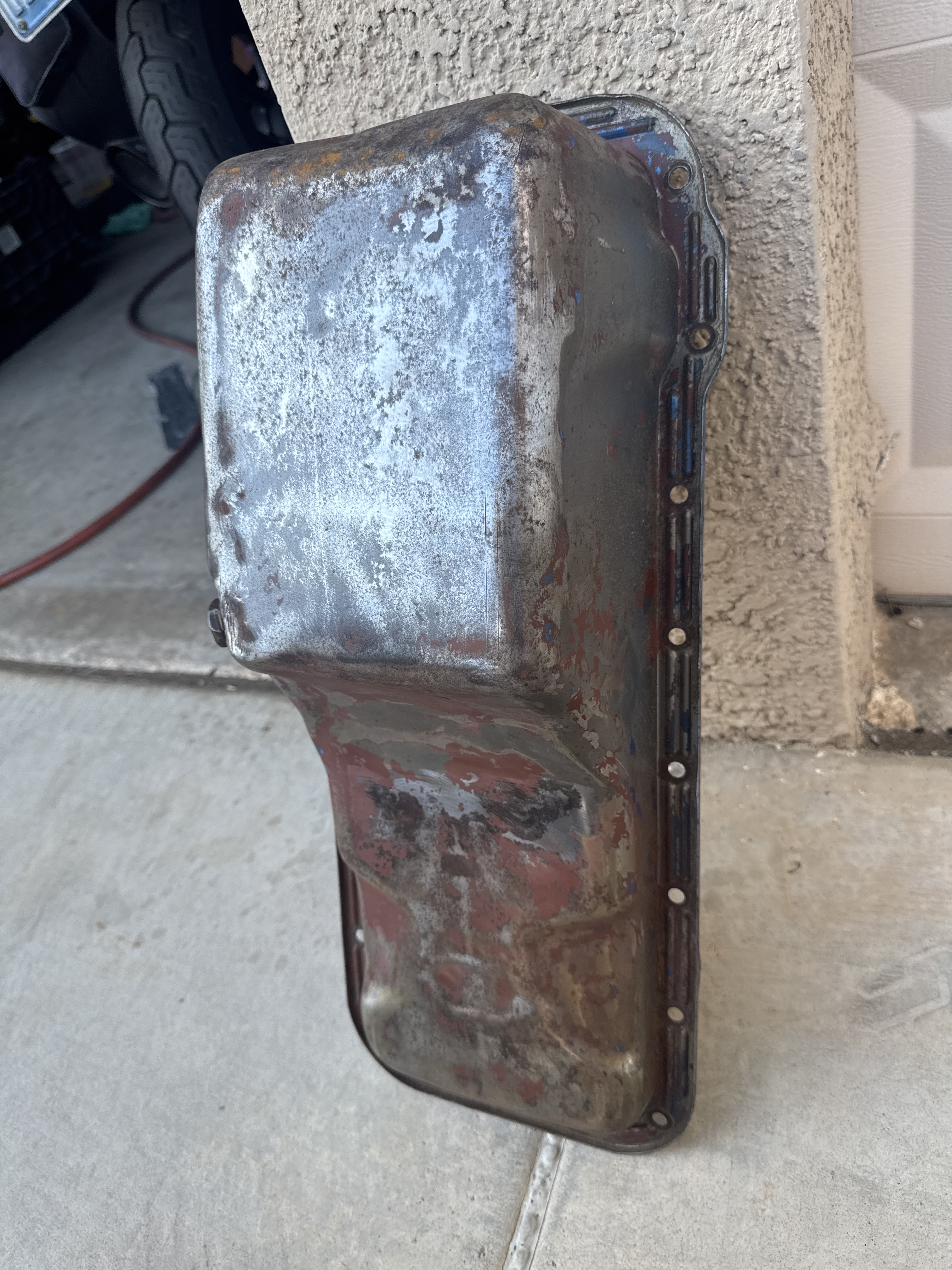

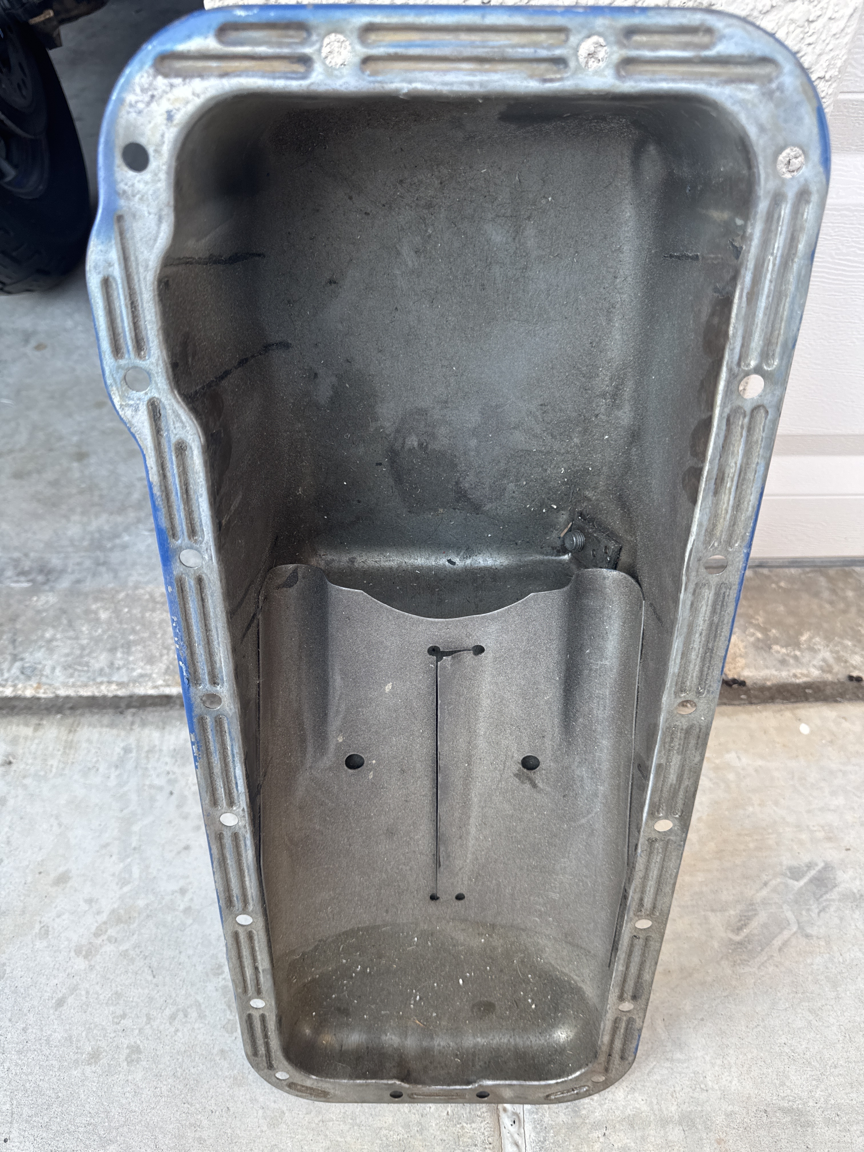

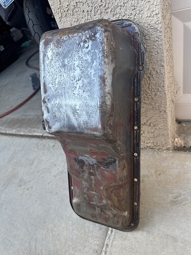

Can someone help identify if this is the correct original pan for a 70 428scj? I don’t see any fomoco stamps but might not be looking in the correct spot.
Maybe 1968 version?
Oil Pan and Windage Tray | Mustang 428 Cobra Jet Registry
So it appears to be a factory pan if I’m reading that correctly. My takeaway is they installed several versions and this is one possibility. It was on my scj since my dad bought the car back in 78 so i doubt it was replaced prior to 78, but I could be wrong.
The 1968 version has a date code in the middle but no FOMOCO stamp. Might be aftermarket in that case there are typically no stamps.
So, Royce, is there a difference between the CJ oil pan and an SCJ oil pan? Don’s website indicates there is a difference but it doesn’t elaborate. Maybe I’m missing something? This is for a 70 scj. Thanks in advance for any/all guidance.
There is no difference between an SCJ pan and a CJ pan.
