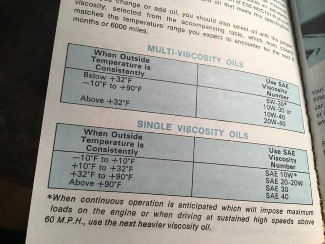

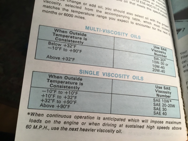

Your glove box book has recommended oil types for various temperatures. 5W-30 is not one of the listed oils. 10W-30 is a typical winter oil grade.

5w-30 actually is called for in the 1970 Cougar owners manual for temps consistently below 32 deg. My mechanic likes the thinner oil in the 351C because along with high volume oil pump, it is easier to get more oil through the 351C’s oil distribution system limitations. But of course I am operating consistently above 32 deg C, and am often over 60 mph. I like the common availability of Valvoline Racing oil with ZDDP, and will go with 10w-30.
