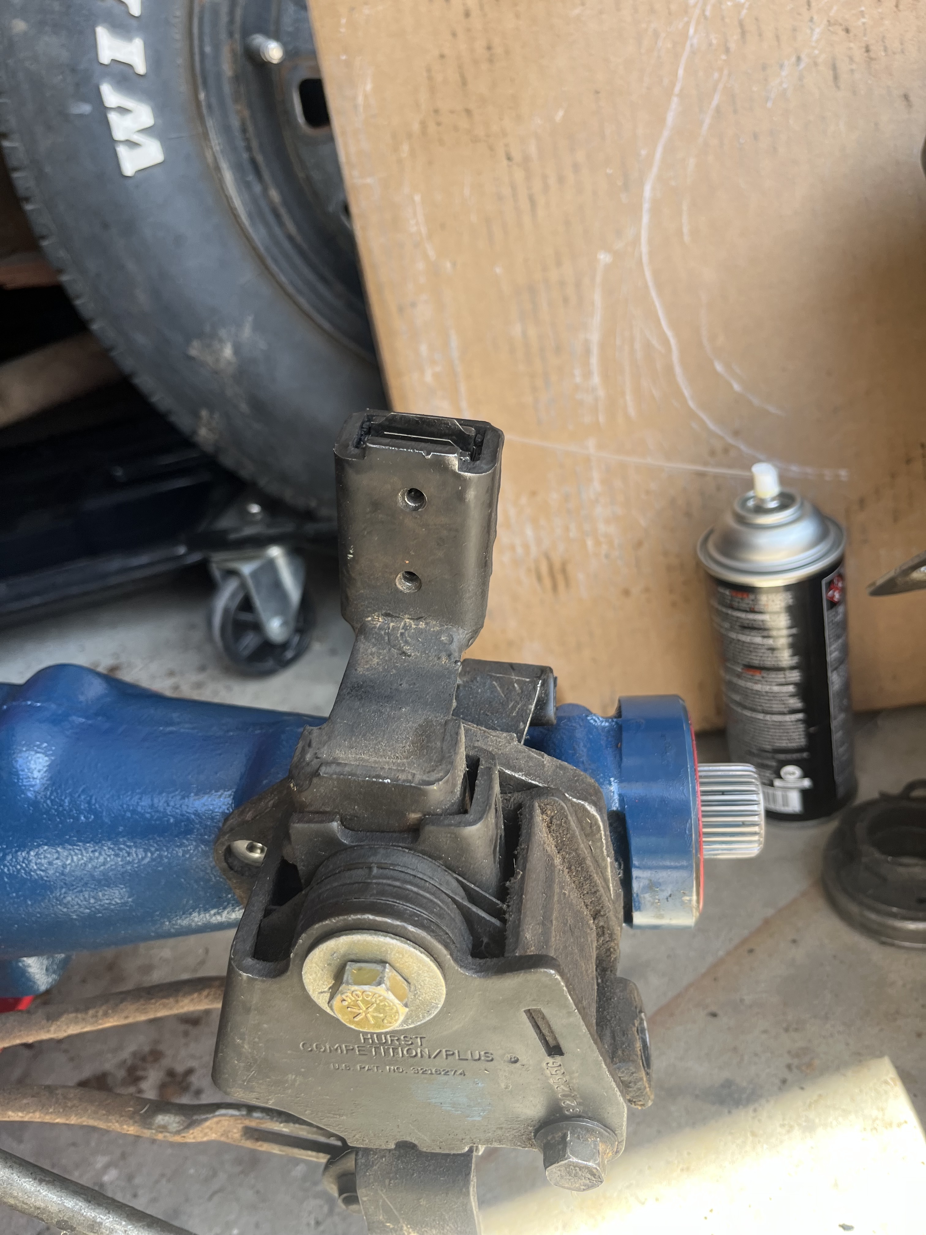

I was going to add this to an ongoing 4 speed transmission swap thread, but I couldn’t find it, either. Anyway- When I bought my 1972 RUG-BJ 4 speed Top Loader transmission, it came with a competition plus Hurst shifter.
I know that the patent number is not for ID, and I am looking at another number kind of on the back edge.
That number is 320255G.
I want to get the pit pack for the levers on the trans, and I believe there is a kit for the shifter as well.
So I guess it’s now two questions.
1- steel or nylon bushings for street use on the rods?
2- What parts do I need for my shifter, or are they all so much the same you just buy a Competition Plus kit? I see lots of reference for GM shifters, not so much on Ford.

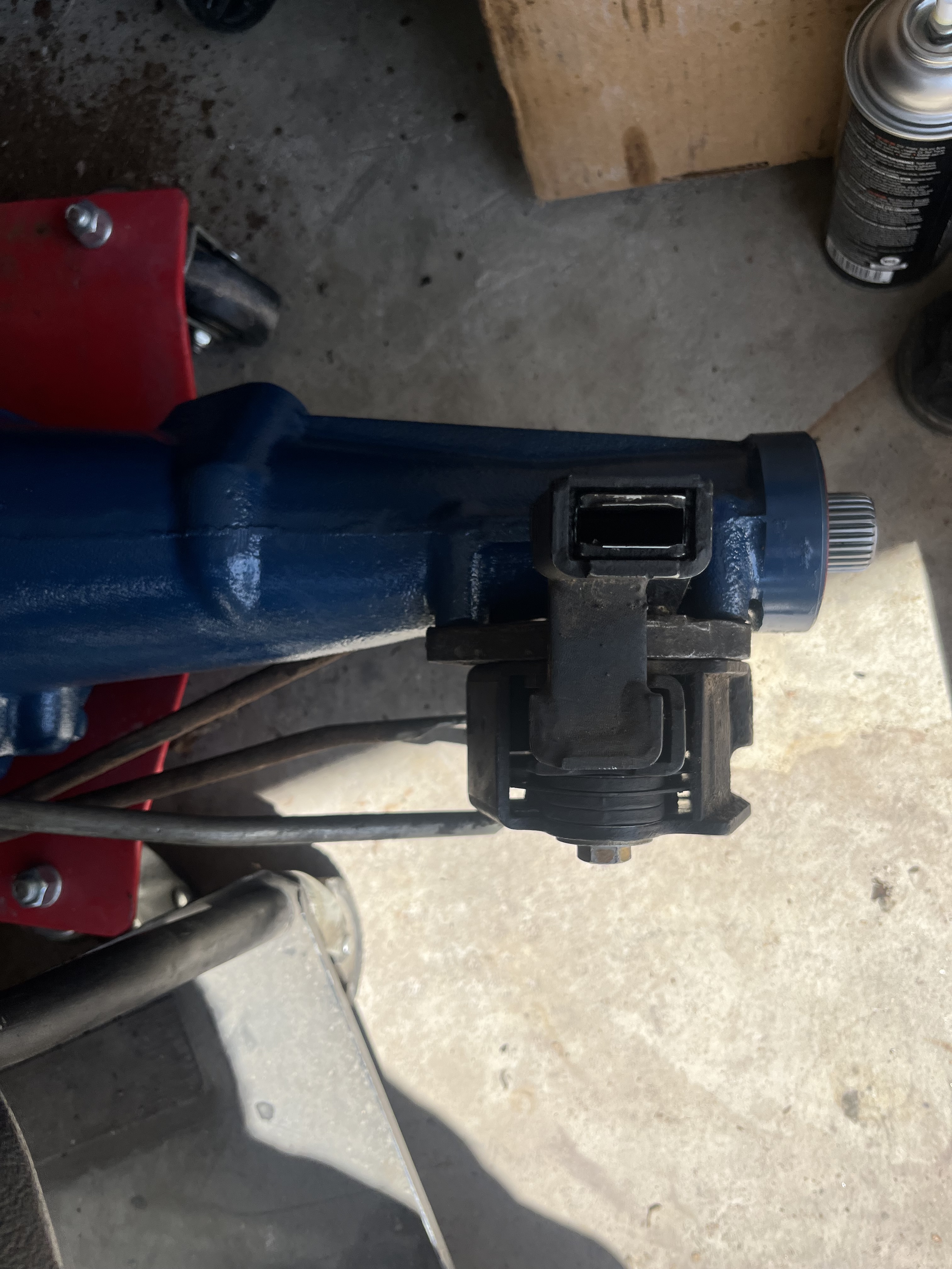

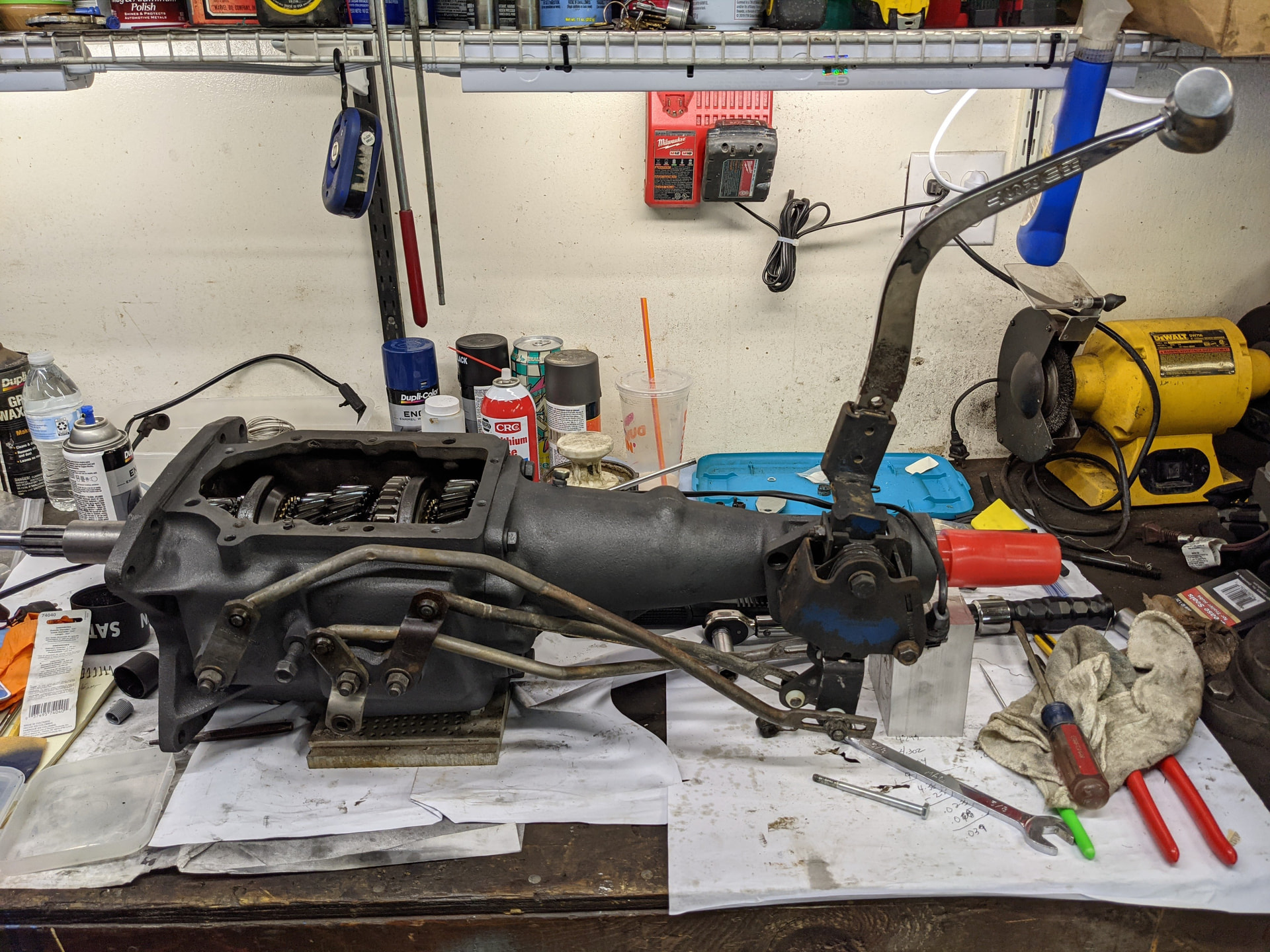

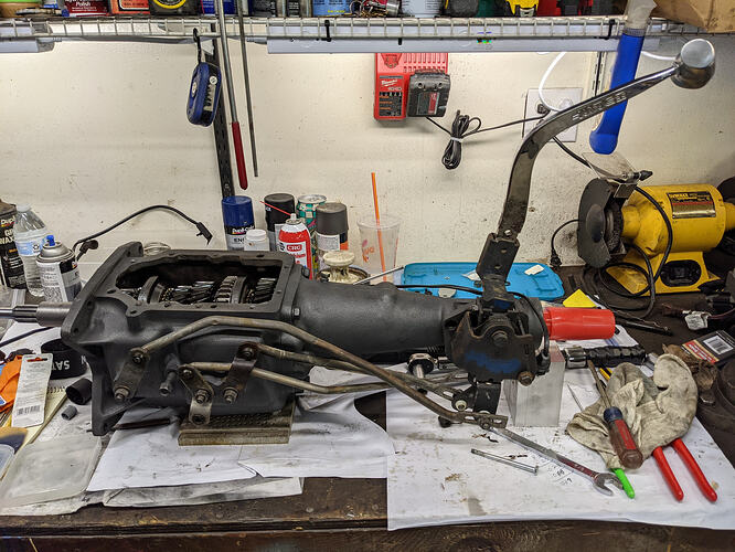

So I took some time to put my 4 speed back together, and that’s when I realized my shift levers I had on the shelf won’t work. My levers have about a half inch hole, and this just won’t do. Have you seen this, or what am I not seeing?

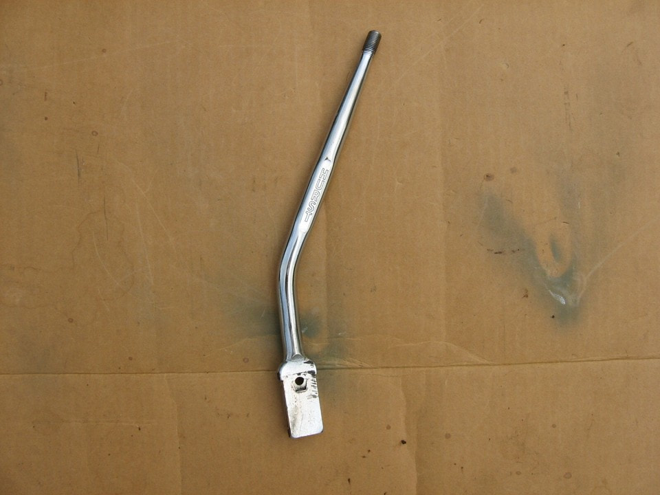

You have a factory installed 70-73 Hurst shifter. The shift lever simply clips into the receiver on the shifter body. You can’t use the aftermarket Hurst levers as they are designed for a bolt-in application.
Hurst Handle and Knob
I appreciate the answer! But then what search term would identify a “ factory installed” part without 3099 other results?
You can use any 70-73 shifter handle. I left the link to the boss 302 page for IDing the handles in my previous post. I’ll include it below:
Search on the ID numbers stamped on the handles such as “Hurst 7275”. You can also use the 72-73 round stick, but I don’t know the numbers on them. Torino sticks will also work but have a different shape.
check with Shifter Doc, IIRC he sells rechromed OE sticks.
Well Hemikiler, once again, you have saved the day. This explains why the number didn’t come up when I was looking for Hurst parts. Sadly I just had the transmission gone through, and am not inclined to pay the current 450~dollars for a shift lever.
I am now kind of facing another dilemma. Do I sell the fresh toploader 4 speed, and factory linkage, or do I dig a deeper hole, and get an aftermarket shifter and linkage? I’m rather annoyed at the moment-
