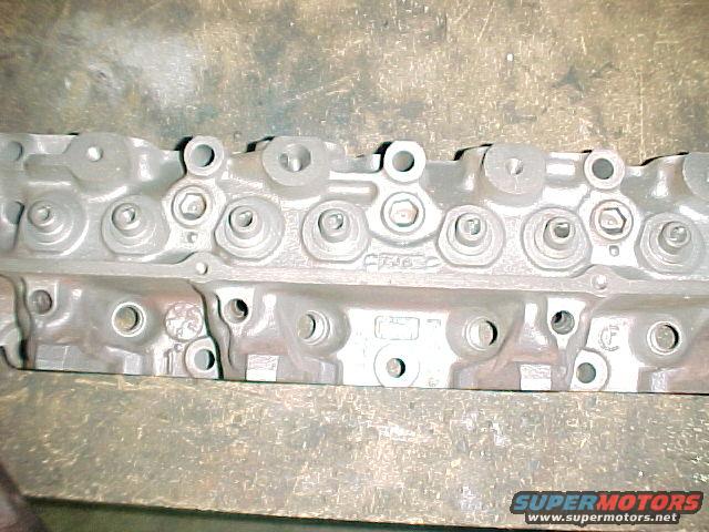

Looks like someone has added the two center lower exhaust holes , maybe for headers or CJ manifolds.
Woops, CJ manifolds don’t use those holes.
The manifolds on the 427 Cougar don’t use them either but for whatever reason they appear on J heads. I took this picture while converting a “J” head on one of my GT-E’s to use a 428CJ exhaust manifold. You can see I have installed a plug in the rear cylinder to prevent exhaust leakage when using the CJ manifold. I have yet to install the same plug in the extra hole at the front (right) cylinder.
Same head showing the 7J6 date code and the C8AE 6090-J casting ID.
