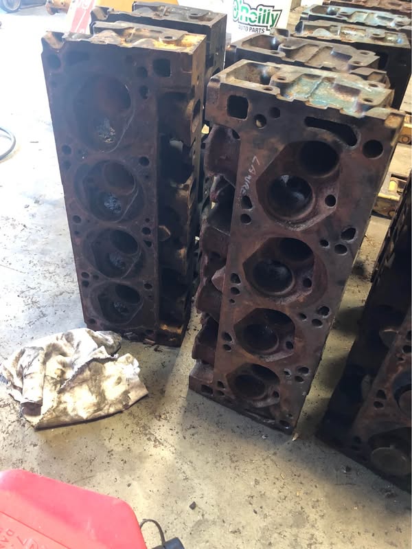

I may have to keep my eye on Australia’s FB Marketplace. Shipping might be prohibitive though. :roll_eyes:
Hmm, California is close than Australia; $600 a pair.
Like I don’t have enought to do already!

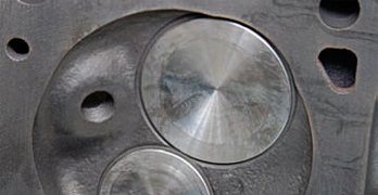

351 Cleveland 4v dot
Our ‘71 convertible has closed chamber 4V heads, and they are marked with both 4 and the dot.
Saw an episode of Roadkill Garage and the hosts repeated the rumor that heads with the 4 and the “cannonball” (their term) were all closed chamber. They pulled the heads and they were open chambers…..
So some comedian in the production line says “watch this, I’ll blow their minds *chink” -
dot
lol - probably not too far from the truth! Things were running pretty loose back in the day.
The “dot” was added to the 71 M-code’s D1AE-GA closed chamber 4V heads just after production started. I have seen several early June ‘70 cast examples sans “dot”, but everything after has it.
