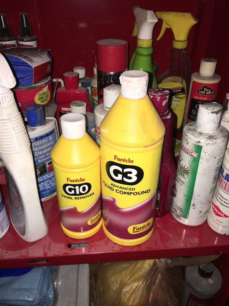

I prefer Farecla products for all color sanding
This product can be hand buffed w/o the use of a machine with good results
