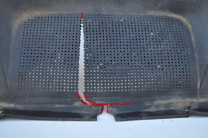

Like devildog said, that patch under the speaker holes will be difficult to conceal. I would think your first priority would be to restore some of the structural integrity of the piece. Otherwise, that crack will just keep growing. Highlighted in red is where I think it should be repaired first. But with what?..maybe some hot staples (is that what they’re called?) from the underside to stabilze the pad in those spots, making sure the speaker hole section is lined up first.
Could fiberglass be used? It would be strong enough to redrill the speaker holes if so desired…

Nah, fiberglass is just too rigid for a flexible piece like this. Plus, it wouldn’t adhere to the vinyl very well.
