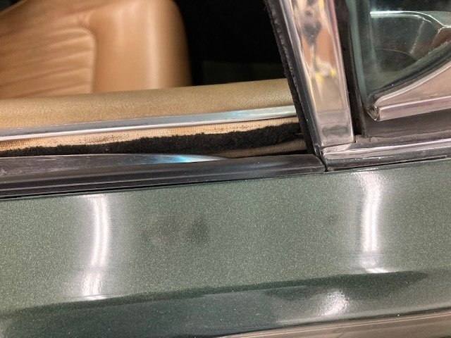

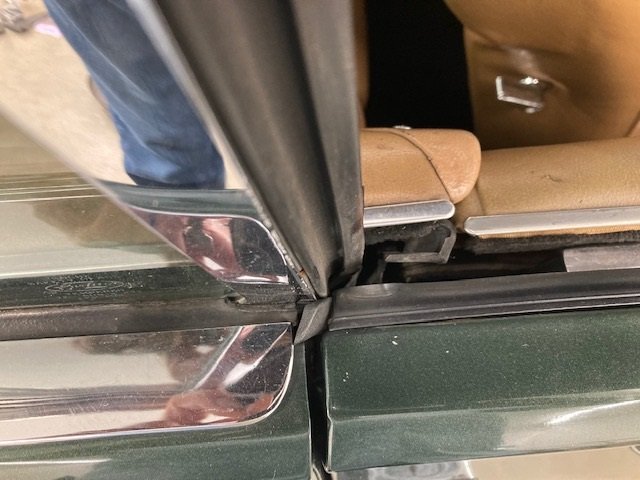

The front is cut square where it meets the vent window. The rear is cut on an angle both inside and outside. You have to drill a hole in the repro parts for the screw at the rear on the inside.

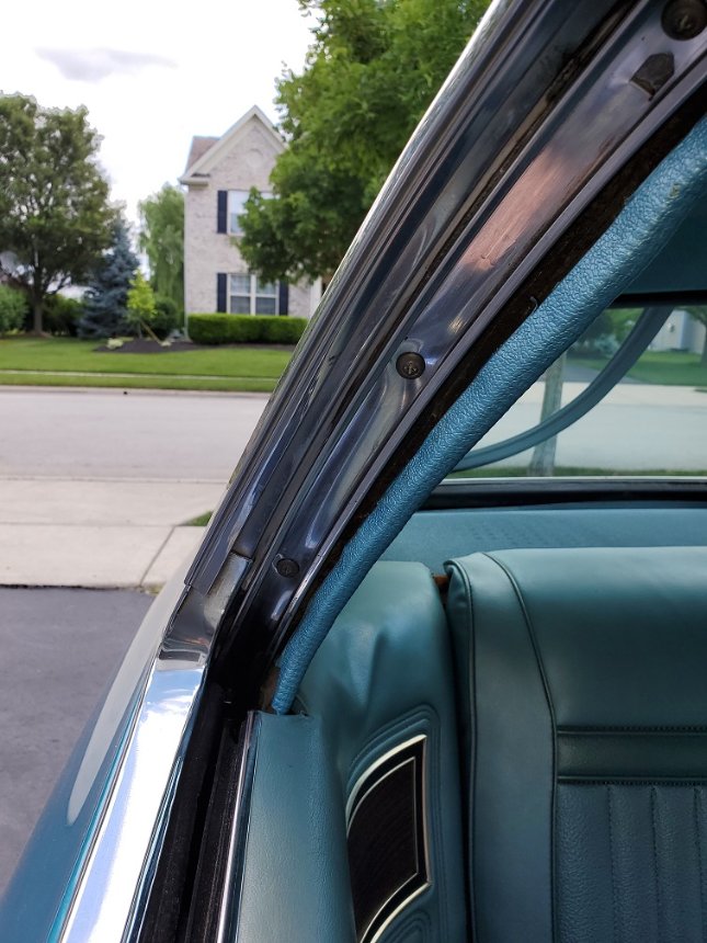

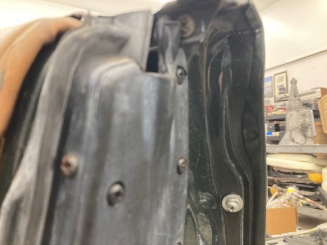

This time it is 70 Cougar Eliminator reference. The stainless trim that goes above the side windows and screws onto the body (that holds the weatherstripping on the top of the door glass). Does anyone have a pic of which screw goes in which hole? I have about 20 miscellaneous sheet metal screws with various heads and thread depths. I assumed they were all alike, perhaps not?
Thanks in advance,
Chuck
It sounds like you are talking about the roofrail weatherstrip retainer. If so that piece is held in place by a phillips head screw with a very flat head that is a little larger diameter than a normal screw. I would say that the threads are about 1/2 inch long. This is the only style screw used on that retainer. Also do not forget that there is a small metal bracket that goes on one of the screws on each side.
This should Help. They’re all the same
Thanks a ton!
