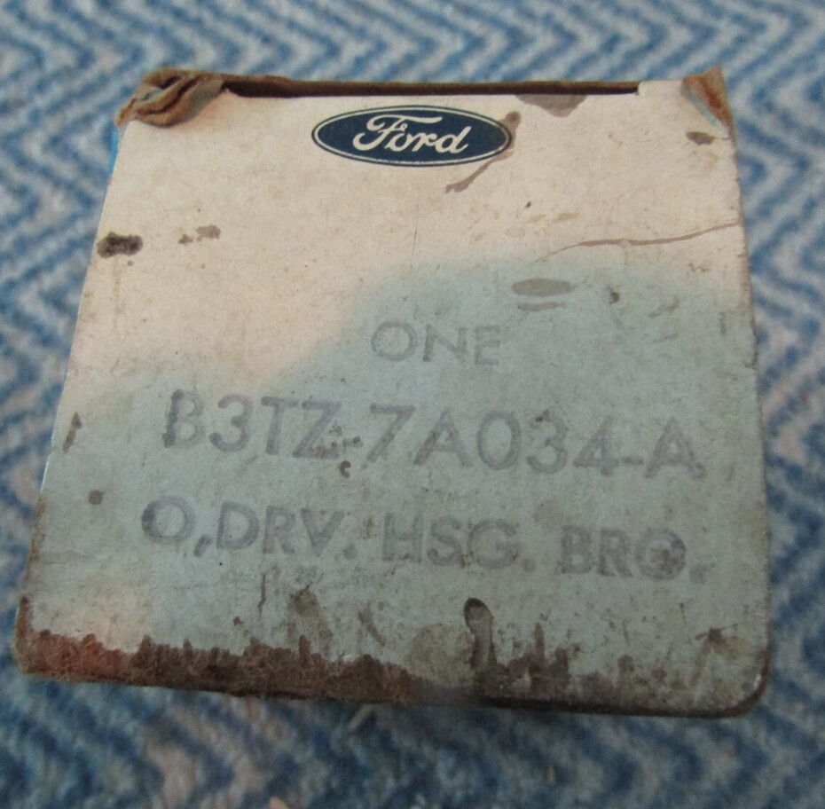

Can someone look this p/n up and tell me if it’s correct for a 70 top loader RUGAZ? Thanks in advance. Jon

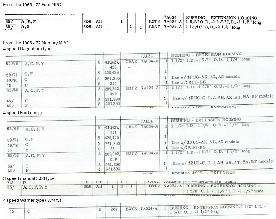

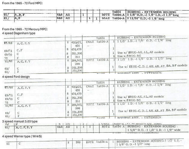

This is what I’ve found in both the Ford and the Mercury MPC’s ( 1965 - 72 )
