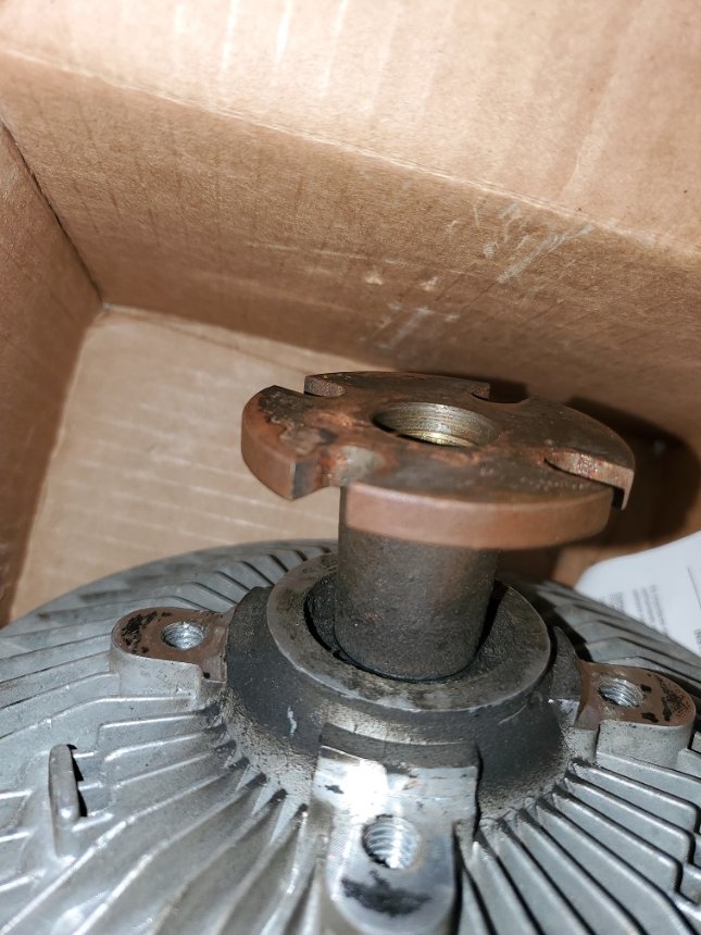

The only thing I can think to add - the first new fan clutch I got for my rebuilt 390 wasn’t doing the job.

Does it ever get hot going down the highway? If not it means you are not getting enough air flow through the radiator. Check to see if there is resistance when you turn the fan when it is hot. Also check your idle speed. Make sure it is about 650 RPM or more. From the factory your car had a thermo vacuum switch to raise idle speed if it started to get warm. Verify that it is still there and working.
There is no overheating when moving down the road. The fan seemed to spin almost at the same rate cool (it is 95degrees out) as it did once it warmed up to operating temperature. When giving the fan a quick flick with my hand at the 12 o’clock position 1 to 2 blades would pass.
Check it when the radiator is hot. It sounds like it is slipping
look for this spatter on the fan and the leakage on the Clutch
Clutch leakage

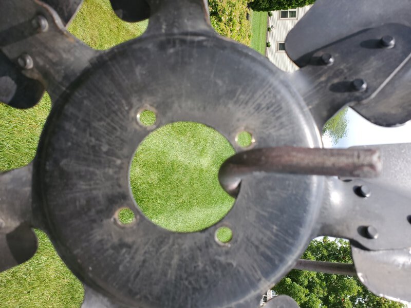

My car used to behave the sane with direct fan which was sitting too deep in the shroud so I removed the spacer to move it half way in shroud, half way ahead toward the engine. That improved it quite a lot.
