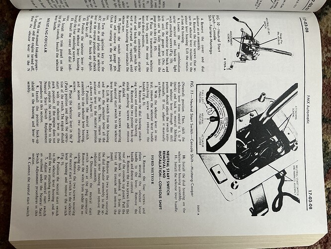

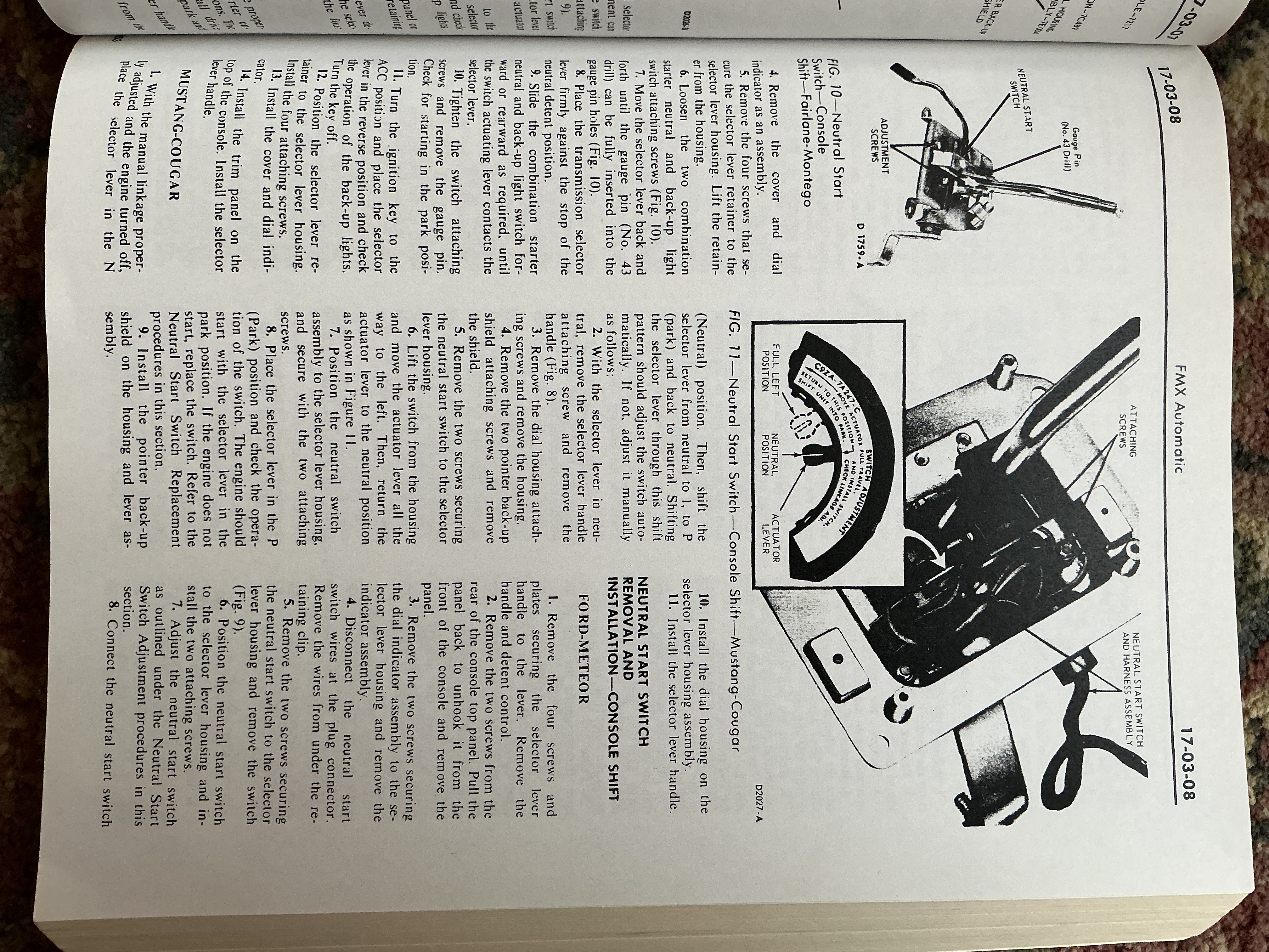

The problem I have is the lights “flash” as I transition gears, however they do not stay on when in reverse. I’m assuming the switch is out of adjustment.1969 base with a FMX.
I belive it is incorporated into the neutral safety switch.
Yes, it’s the arch shaped switch at base of floor shift, and the shop manual has detailed instructions for adjusting it.
