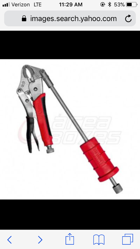

I used a little heat and a vice grip slide hammer. Mine was home built by welding a nut on the jaws of the vice grips or you can buy one like this… Good tool to have around either way
Thanks for the replies. I’ve been using vice grips and a hammer but so far have just managed to groove the dowel. I’ll try some heat as well but if that doesn’t work I guess I’ll just grind it off.
