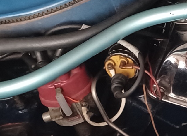

20230708_110757
In 1981 summer I had my wisdom teeth pulled out. Soon I was turning 18 and parents GM insurance was no longer going to be available, especially with my grades… On the way home with cotton in my mouth X4, had Mom stopp at my local speed shop in Racine, Wisconsin and bought this Mallory dual point 255301. Had it recurved to this motor. I put the second set of points in it in 1998 before taking it to the U.K. Even ran it on 1 set sometimes. Flawless
