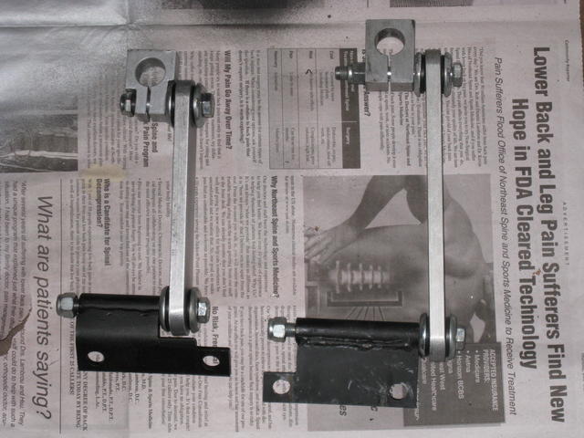

Long story, but the “Stam-Bar” 3/4" adjustable rear sway bar ends/links were smack-dab in the way of the Cobra rear calipers and brackets. I looked at possibly mounting the calipers on the leading side of the differential but the E-brake cables would have been too difficult/too large a radius to make the turn. So, I modified the end link parts to make the link mount on further inboard, over top of the spring rather than on the outer edge of the spring. Here’s a couple of pictures of that work.
Shortening the end links themselves:
Not sure why my bar looks so much different than the pictures Cougar Bill sent me of his, my links are WAY longer (and the bar end clamps were actually banging the wheelhouse/trunk floor pinchwelds as a result). My bar ends seem shorter as well. In any case it was modify or buy something else. You guessed it! I went with the modify route. Made a number of measurements to ensure my modifications would in fact alleviate the interference at the extreme of suspension travel.
Here are the links and associated hardware, on left is (DS) modified, right (PS) original:
The links now mount opposite from original, I abbreviated the bar ends clamp assemblies considerably, in the original orientation the bolt ends were (just barely) rubbing the frame in addition to the problem I described. The leaf spring bracket I had to whale on to bend the plate into an angle sort of affair (so the link end could sit over top of the spring rather than off the edge of it) and then cut back the tube and part of the bracket plate to position the link more or less vertically from where it now attaches to the bar ends.

A good 1/2" to 3/4" between bar end/link clamp and back of Cobra disc caliper, brake hose is out of harms way as well (but was sweating this whole thing a bit, (fingers-crossed) made it work, so far appears that way anyway!
