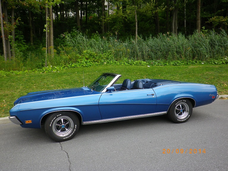

Mine has 235/60/15 tires on 15X7 Magnum 500’s. I think this is the best size for 69-70 Cougars as they fill the wheel well with no rubbing issues.

235/60 R15 are the closest fit at 26.1 inches diameter

Here is what it looks like with 215/70R15 on 15" magnum 500, standard stock suspension (collapsed a little as front coil springs need be replaced).
Awwe maaannn … they look good too!
Are they a slightly higher profile tyre than on Jeff’s car above? Dan’s look like they have more air in them.
Well as far as I understand tire numbers, yes mine would be higher profile (70) than Jeff’s (60) and you are definitely lower profile at 50.
However mines are much narrower (215) than Jeff’s (235), you are in between at 225. Width is not visible on the profile view. 215 is Ok for stock appearance but definitly too narrow for a thick performance look (looking at back as when you follow).
