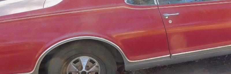

Original 1968 pin stripes for reference. Please do not post any photos of 1967 pin stripes here. Start a new thread about 1967 pin stripes if you need to.

Royce - in your top picture I’m not seeing the typical masking tape lines at the seam, in fact it looks like there’s a fuzzy edge as if they were sprayed on. Thoughts?
Looking back at the other thread, the pictures of the red 68 there look like the stripes were brushed on. The cars I was looking at here (mostly 67’s) all appeared to be rolled on. The pinstripe mystery continues.

I meant the red car you posted.
Oh - it looked typical to me in person, perhaps the ends got softened by buffing and polishing over the past 50 years.
