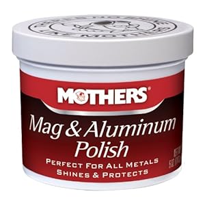

Shine Seal is too expensive for this (small) need! If it was during my resto, well that would be a different story.
Going to give this a try (should have thought to check before now):
$5.99 at Advance Auto (Did I mention I LOVE Advance Auto?)

Mother’s worked well! Just the ticket and cheap too (read on).
You KNOW I love a bargain, when I went in to buy it for some reason I thought to bring a printout of the online page from the Advance website. Sure enough, the local store was selling it for $1 more. I asked if they could honor the web price and they told me no! So, not one to be beat out of a buck, I went home, used a 20% off no minimum order coupon (P20 good through the end of January IIRC) and ordered online to pickup in store and picked it up the next morning on my way into work (so no additional trip wasting the savings in fuel!). The store is in a 3% tax zone, total $4.96 out the door! Did I mention I like a bargain?
So Mother’s good, Advance online ordering with coupon, good too!
