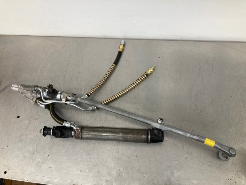

The lines carried by auto part stores often don’t fit right. Here’s what it looks like with Blue Dot brand hoses.
Are the Shafer hoses any different in fit / quality, or are the Blue Dot hoses a better quality hose?
Never have seen the Shafer ones so I don’t know. The Blue Dot hoses are built to Ford drawings so they fit really well.
Chokostang seemed to recommend the Shafer for the good drivers, and Blue Dot for concours…probably for cost difference.
I used Chokostang and their pieces fit just right. The stuff at the auto parts store sort of fits, for a few bucks more you get something that fits just right. Remember these cars are 50 years old (wow I am getting old).
