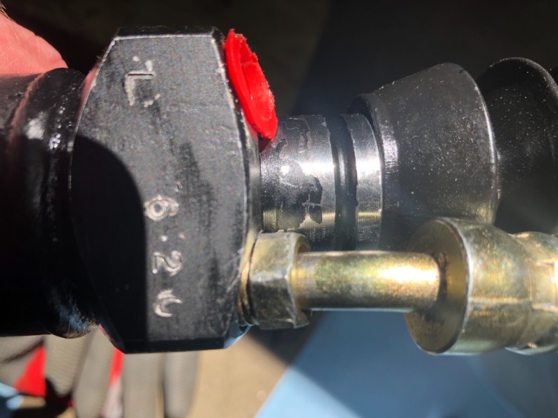

I bought a replacement from Lares (model 10022). The problem I am having is that the hoses I bought (Scott Drake) bottom out before it seats properly. The hoses are standard and worked on the old cylinder fine.
You can see in the pic where the nut bottoms out.

there should be a replaceable seat in the bottom of the hose mounting recess. Are they in place?
The other end of the hose… does it have a longer fitting? If so swap it…

Try a copper sealing washer…it may give you enough reduction in depth to form a seal

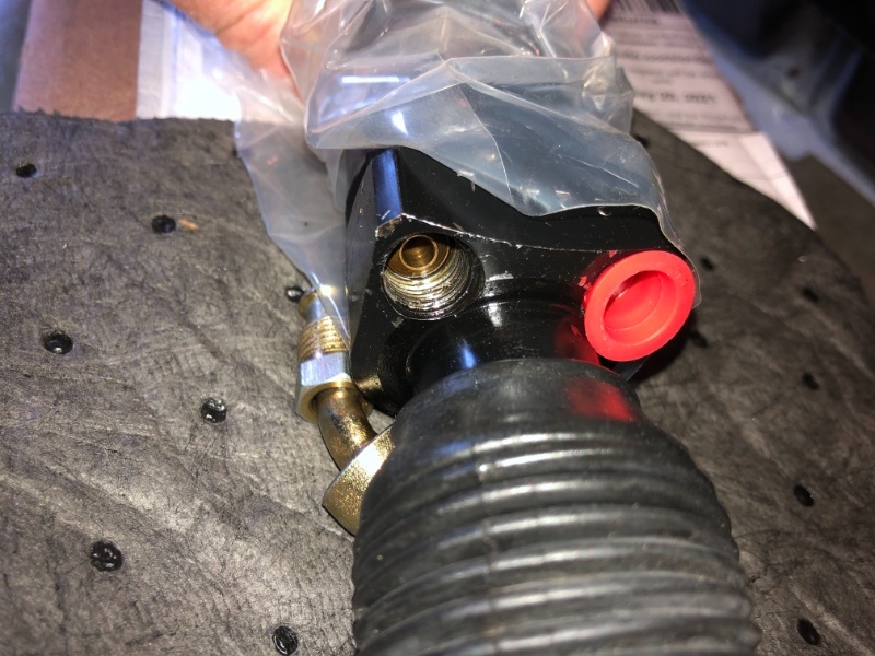

I took a pic of the tube seat hole and it appears there is already a seat in there. I also checked both ends of the hoses and the treads are the same on both. I have a email into Lares for their answer.

The Lares stuff is the issue. The cyl has too deep ports. Too bad about another reproduction that didn’t quite make it…

I wonder if there are different height inserts out there and the ones in your cylinder are just a bit too short? Or perhaps grind down the part of the casting that interferes with the fitting so it can screw in further.
