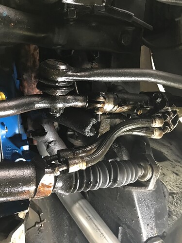

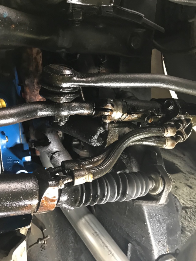

Power steering hoses?
Is this something I can buy locally?
Or do I need to find them through specialty store?
They seem to be leaking.
Try NAPA or NPD. I would suggest taking a close look and determining for sure whats leaking as there are many places the leak could be coming from before throwing money at it.
Give the full power steering linkage a good cleaning. Then run the engine and look for what is leaking. Also a lot of parts store hoses do not fit well. I recommend WCCC for good parts.

If power steering is working fine… should I ONLY look for leaks and fix as I go?
Or consider a full replacement?
Mine was still working even when the ram cylinder was spewing fluid, but I was losing it as fast as I could pour it in. I did all my hoses first not realizing it was the cylinder. They probably needed to be changed anyway, but it would have saved me about $150 had I been smart enough to figure out what was really leaking before diving in.
Definitely do a clean-up and wipedown, then take a look to see where it’s leaking and you probably only need to replace that hose or part.
Short hoses you almost need to go with something quality like the Scott Drakes hoses. The pressure and return hoses you can get away with auto store versions, but they’re also not a great fit (I had to spend a lot of time tweaking mine so it didn’t contact the pitman arm at full lock). If you can swing it you won’t regret the higher quality hoses.
Might also consider doing the big block/1969+ hose routing to get them away from the exhaust manifolds.
Great to know. Thanks.
I just went under the car and there was one drip on the ground. I wiped everything down and didn’t see any leaks.
The power steering fluid is full.
Should I just monitor it for the next week?
Have you rtied tightening all the hose connections?
No. I’ll try that next.
You’ve had a lot of stuff in and out of that engine bay. There’s always the chance that moving the hoses around just loosened up the connections.
