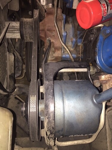

Anyway, looks to be about 1/8 inch off. Gonna add two washers as spacers in the morning. Here’s a shot.
Looks like you have a foreign part there! Maybe that nuts is metric? or Chevy? lol
Look here for your spacer
https://www.amkproducts.com/search-result/?ser=spacer
Hah! Yeah, I’m sure that “nut” is non standard. Does anyone know the proper spacer size here?
WCCC has a power steering spacer for my car WITHOUT a/c. It is listed as 7/16 i.d. by 3/4 inch. My car came with a/c, but it has been removed. My “spacer” nut and washers are about 1/8 inch shy of 3/4 inch, so by eyeball it appears this spacer would work.
I can’t see why an a/c compressor would affect proper spacing? Side note -this original used spacer is about $30. A repro is $6. :stuck_out_tongue_closed_eyes::stuck_out_tongue_closed_eyes:
IIRC, the A/C bracket(s) use a common bolt, mounting point etc.
That’s why the spacer was used to "make up the thickness of A/C bracket(s) in non A/C Cats.

That makes sense. The a/c bracket was probably 3/4 inch thick at that bolt.
Annoying squeak is gone.
I added two washers to get the 3/4 inch spacer previously provided by the a/c compressor bracket. I used a wonderbar/superbar to gain leverage between the bolt and the bracket. I did it myself, but it would be better with two people - one levering the wonderbar and one tightening the bolt.
