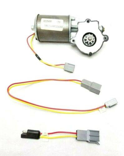

Are these a good choice for replacement power windows for 1970?
I don’t recognize the maker and they are crazy expensive. You can find Dorman replacements for 1/3 of that price or less.
Those are absolutely priced into the stratosphere. Rock Auto has them for a fraction of that price.

Wow, that is a very massive difference in cost! Have you had good luck with the Dorman replacement parts?
The Dorman units are solid. I used one on my passenger side over a year ago and have one in a box for my driver side which has been running slow but still works.
I bought these parts, thanks! It will be a while before I can try and use them, but they should be fine on the shelf for a while.
I have a stash of good used motors from various parts cars, so I’ve never had to buy one. I have used the ACI gear sets and they work fine.
