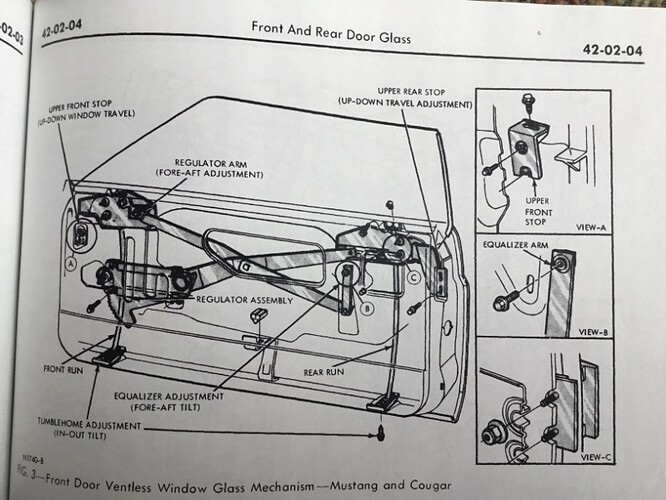

Sounds like a new relay should fix your electrical problem. I’ve got bolt in glass, but went through the door glass alignment on my 70 last fall. Lots of adjustments and most of them affect each other so you’ll be repeating all of them 2 or 3 times. Just be careful not to strip threads in the aluminum stops. Shop manual has the detailed info. First thing I did was adjust adjust quarter windows to best fit weatherstrips. Then adjusted door window tumblehome to match quarter window and weatherstrip. Then fore/aft to fix interference with quarter window. Then front and rear stops to determine closed height front and back. Finally adjusted fore/aft tilt so that window stays at about same tilt all the way from open to closed. Turned out great, but it’s real frustrating. I just about gave up several times and tossed a few tools across the garage.

Also, it is very critical to re-glue the window channels back in their “right” position, as there is as NOT much front to back adjustment as you would think. I have worked on several Cougars where the previous owners have re-glued the glass, only to have it in the wrong spot, and therefore the window could not be adjusted properly. Anything more than 1/4 inch off and you can have problems.
