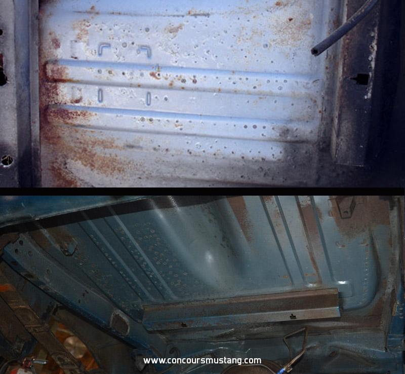

Some examples I had handy
Top one shows a floor color similar to what your reporting but in this case the exterior color is a lighter color that contrasts with the floor color. That is from a very early 71
Light gray versions
Red Oxide primer sealer period
Do have some dray gray with blue or greenish tints (very typical on allot of 64-73 Dearborn cars) I believe also some where
That funny! The lower one is from my 71 resurrection’s thread.
