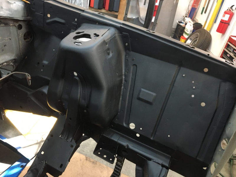

Outer fender aprons cleaned and black epoxy primed. Engine bay sanded, cleaned and partially epoxy primed.
Front suspension components bead blasted, painted, and staged for re-assembly. Some of the grease boots on the driver’s side lower ball joint, tie rods were damaged by the fire. These components replaced to be on the safe side.
Factory paint marks recreated where observed, or as specified on the build sheet / Mercury MPC.
The dirtiest, greasiest, nastiest work is now complete - next step is body work and paint. This is a different kind of dirty-work. I’ll need to mask off the suspension and engine bay to keep it reasonably clean.

Engine bay being painted today.
Pictures will be posted when complete.
This is a MAJOR milestone.
No more grimy, greasy tasks, and suspension and steering soon will be reinstalled. Woohoo!
Gorgeous day for painting. 52 degrees, no humidity.
A few runs and some dust is inevitable. I doubt the Dearborn plant gave a crap about this, so maybe I shouldn’t worry too much either. Most of this will be invisible when the car is complete…
I always paint the radiator support last. From time to time I need to climb into the engine compartment when installing the suspension and steering, and the paint can get scuffed/scratched in the process. I also need to finish up the top of the cowl.
Pretty satisfied with this result.
