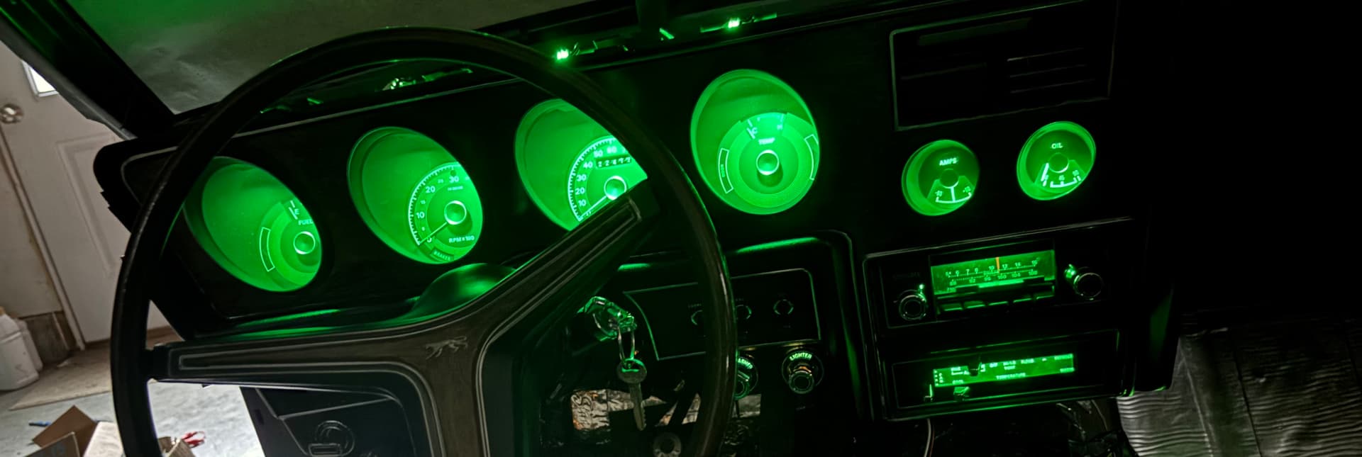

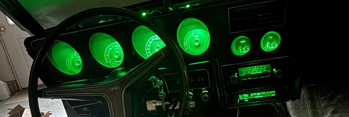

Added Green LED bulbs to the dash.
Found some reasonably priced type 57 and 194 replacements on Amazon and upgraded the instrument cluster, radio, heater control.
Under $10 for a set of 10. Antline brand. There was NO WAY I was going to spend $70-80 for those Hipoparts bulbs!
They are bright and make the gauges highly legible. My night vision has gotten very poor and the gauges were always hard to read even with brand new incandescent bulbs.
The dimmer still works, but only in “steps” versus the linear adjustment with the OEM bulbs
This digital picture really exaggerates the color - they aren’t quite so “alien green” in person…
