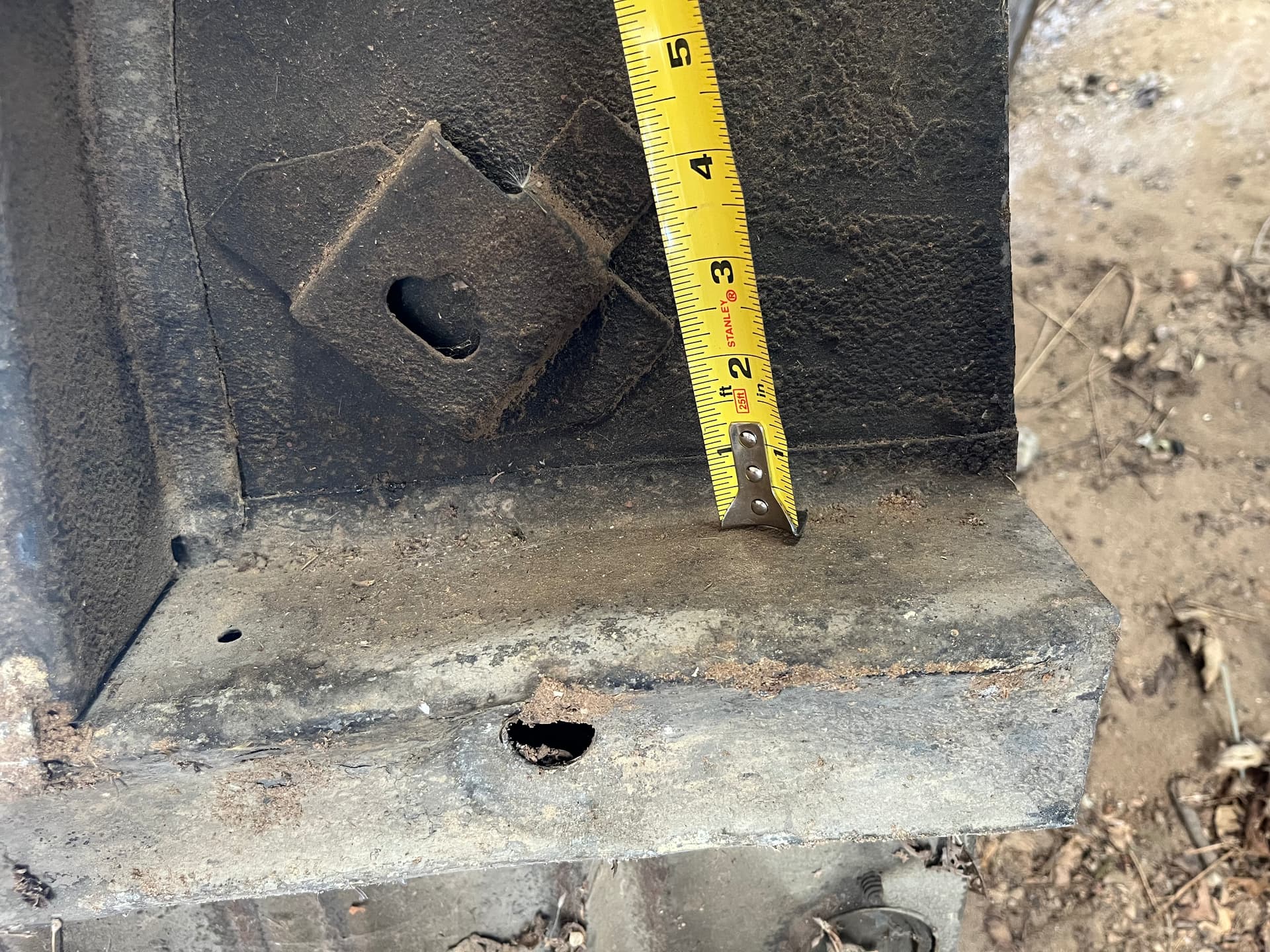

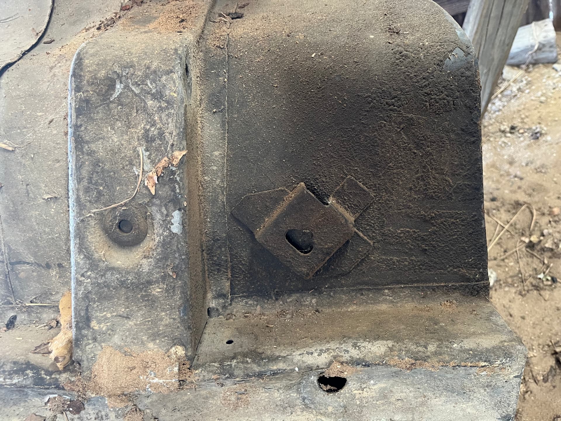

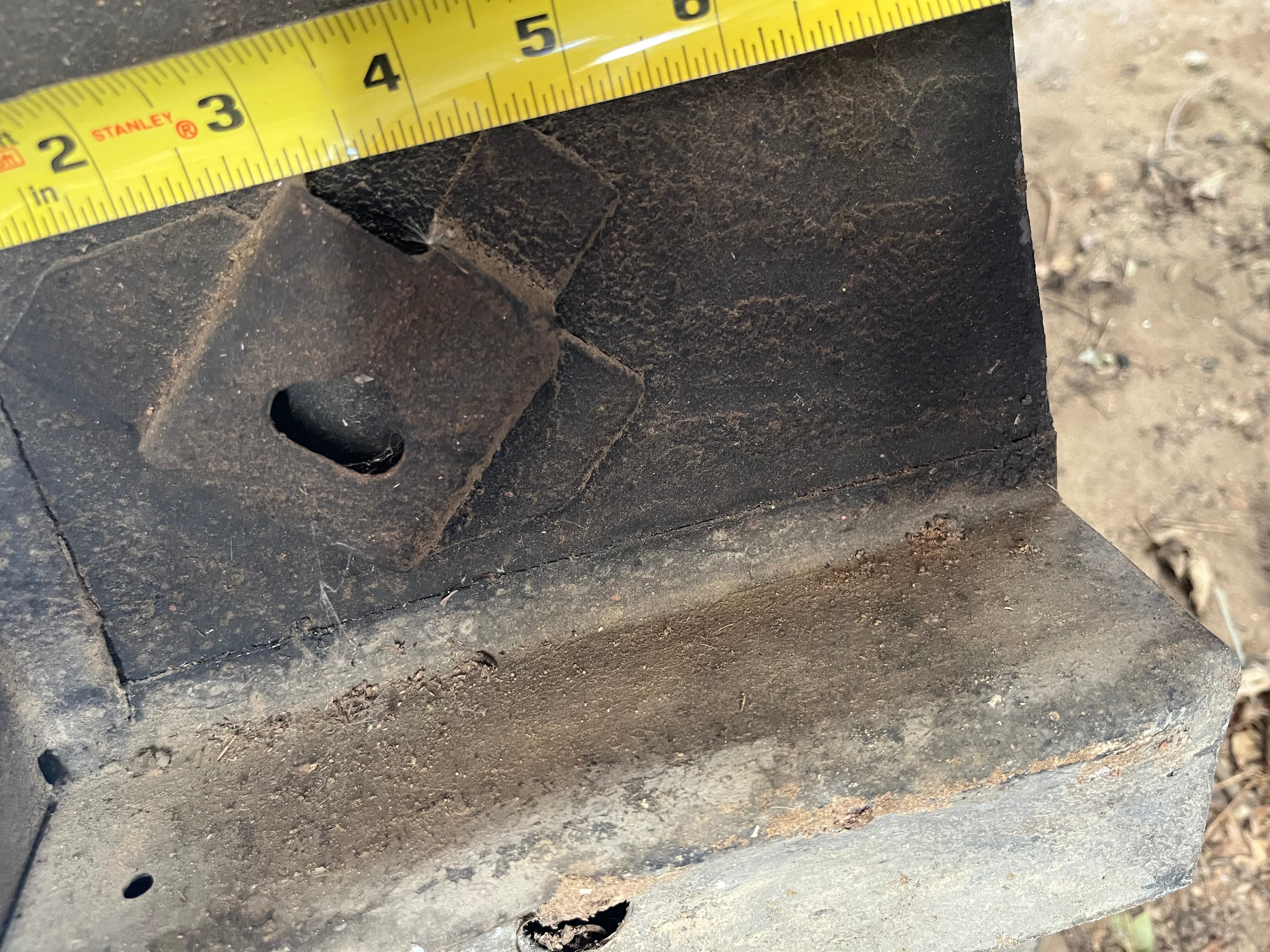

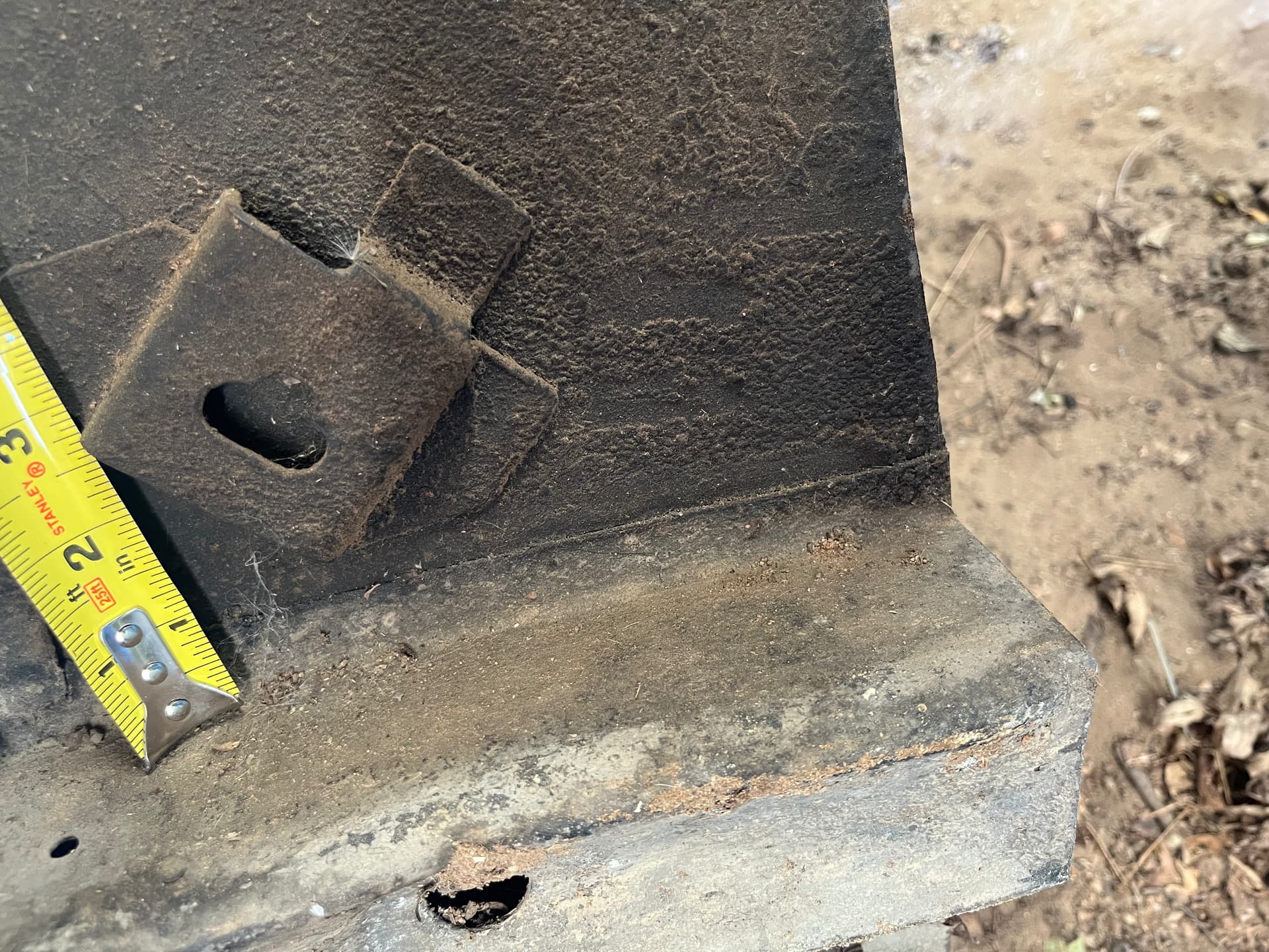

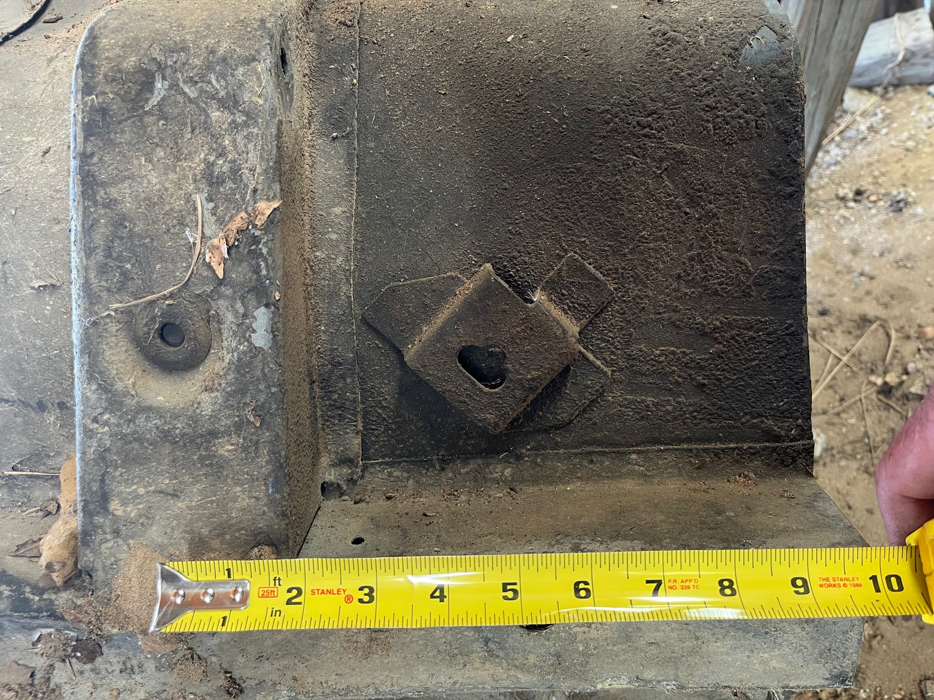

I had a guy that came out to my house, and replaced the passenger floor pan in my 68. Great price, and got it done. But, we missed replacing the park brake cable mount underneath- has anyone got a couple of measurement points handy?
