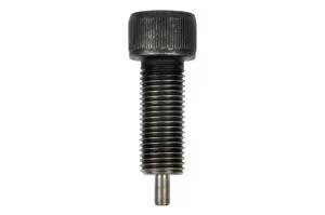

After you get the valve centered use one of these.
Brake Distribution Switch Tool

Used the small needle nose approach- worked perfectly- all centered now with centering tool in place- THANKS ALL!
