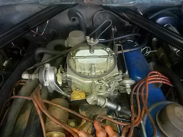

I bought the Classic Tube MUC1009 for my 67 289 Cougar running the original Autolite 4300. It fit with no issues. NOTE: I have California emissions on my vehicle.
[attachment=0]20150215_120413.jpg[/attachment]
Coach Jack

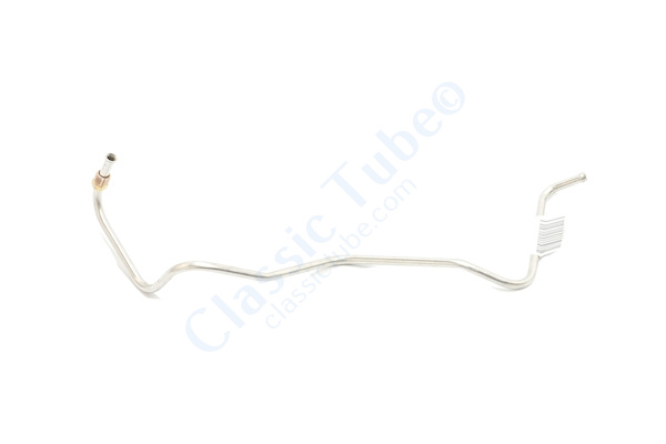

Wow coach! Thank you! After looking at classic lines description, may I ask how you decided on this one? All it says is mustang and galaxie. I had even sent a photo of the ford engine assembly manual for pump line routing for my application. I’ll set up the return for line #2 and order this one.

Edit, hey coach, summit lists this pn for a 2bbl big block. Is the catalog that bad for these things??

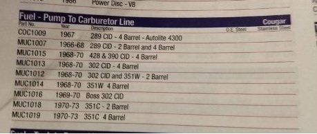

I’m pretty sure that the Classic Tube printed catalog back in 2013 specifically called out 289 with 4300 for the 1009 part number however the latest online catalog makes no mention of 4300 applications. You should call Classic tube and ask them for their recommendation, if they tell you the 1007 or 1013, tell them NO then tell em to grab the old catalog and lookup the 1009 description.
UPDATE - Classic tube Catalog #11 published in 2010 shows COC1009 289 CID - 4 Barrel - Autolite 4300. The latest online catalog does not show this part number however I believe the MUC1009 is the same, but you should call them directly and ask. Note my cougar is a 67 standard Cougar with a 289, autolite 4300 with California emission, non ac car.
[attachment=0]fuelline.jpg[/attachment]
