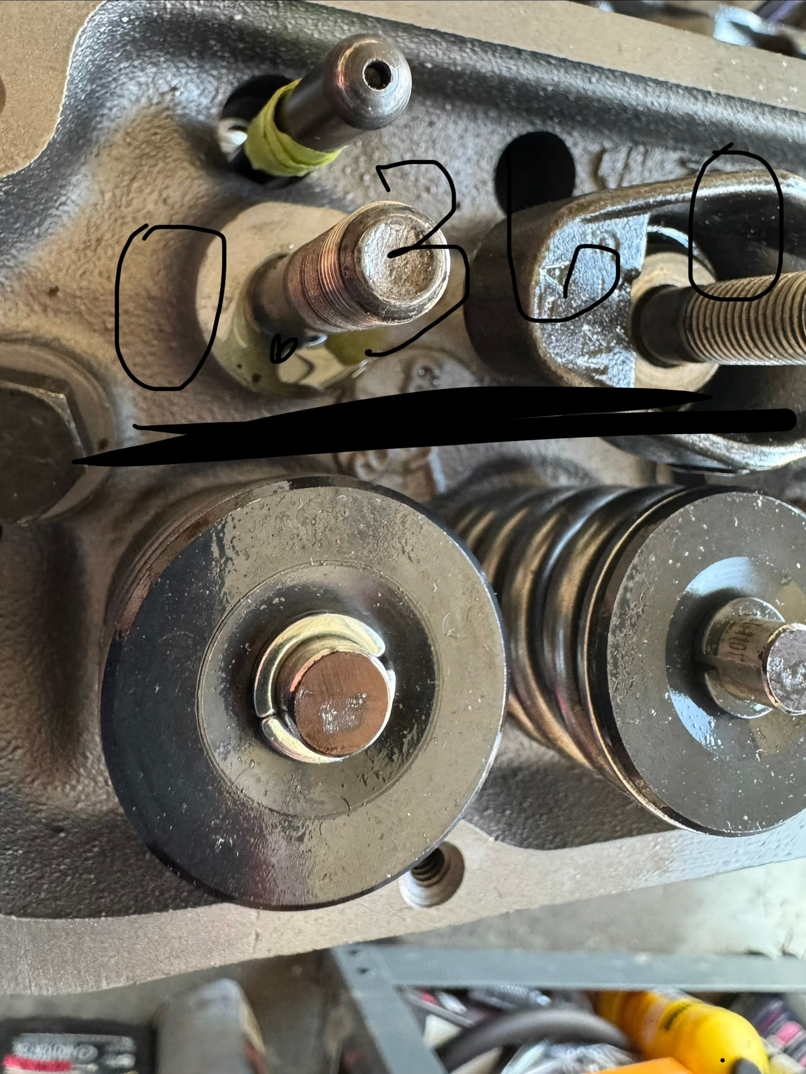

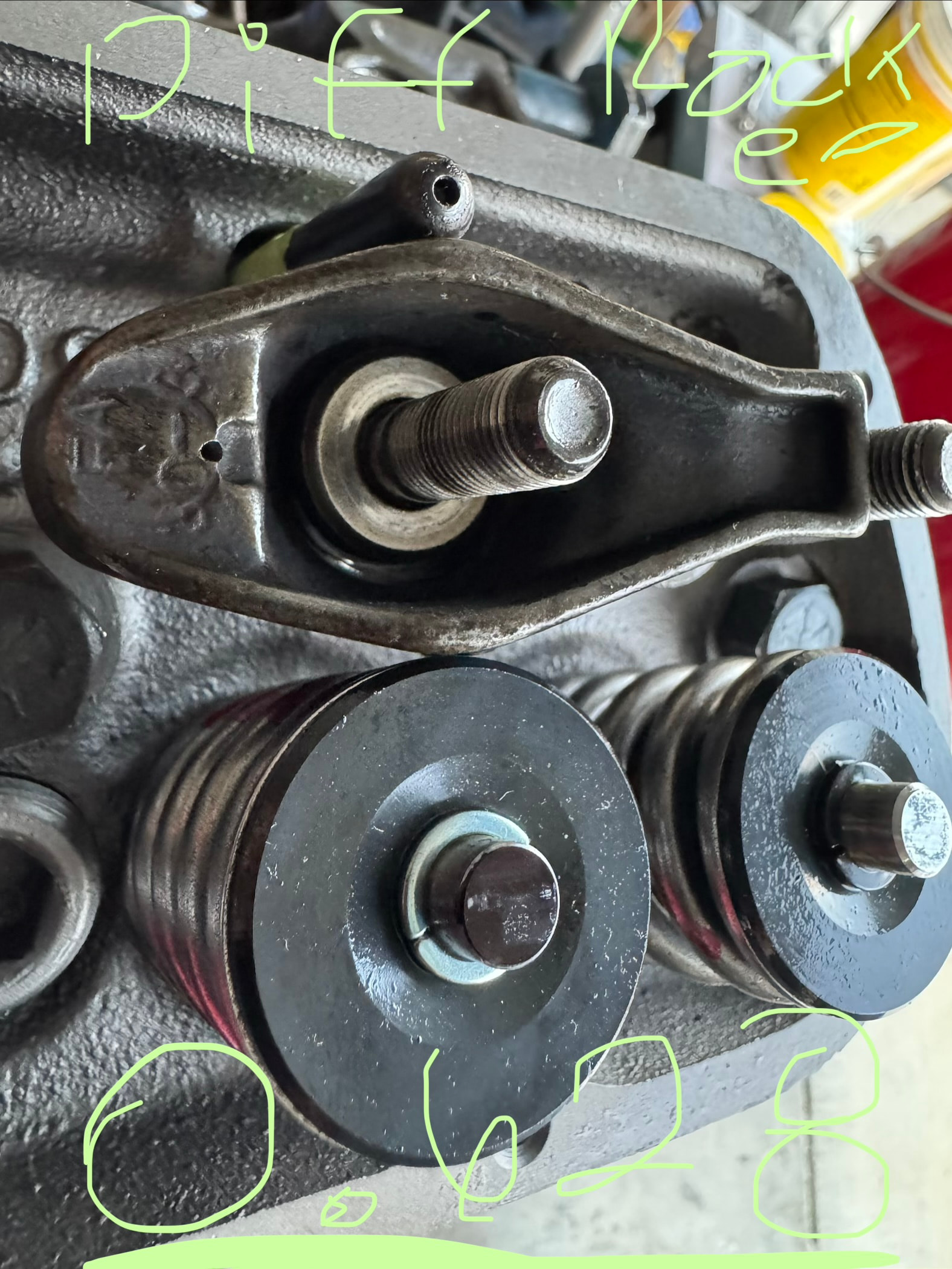

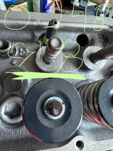

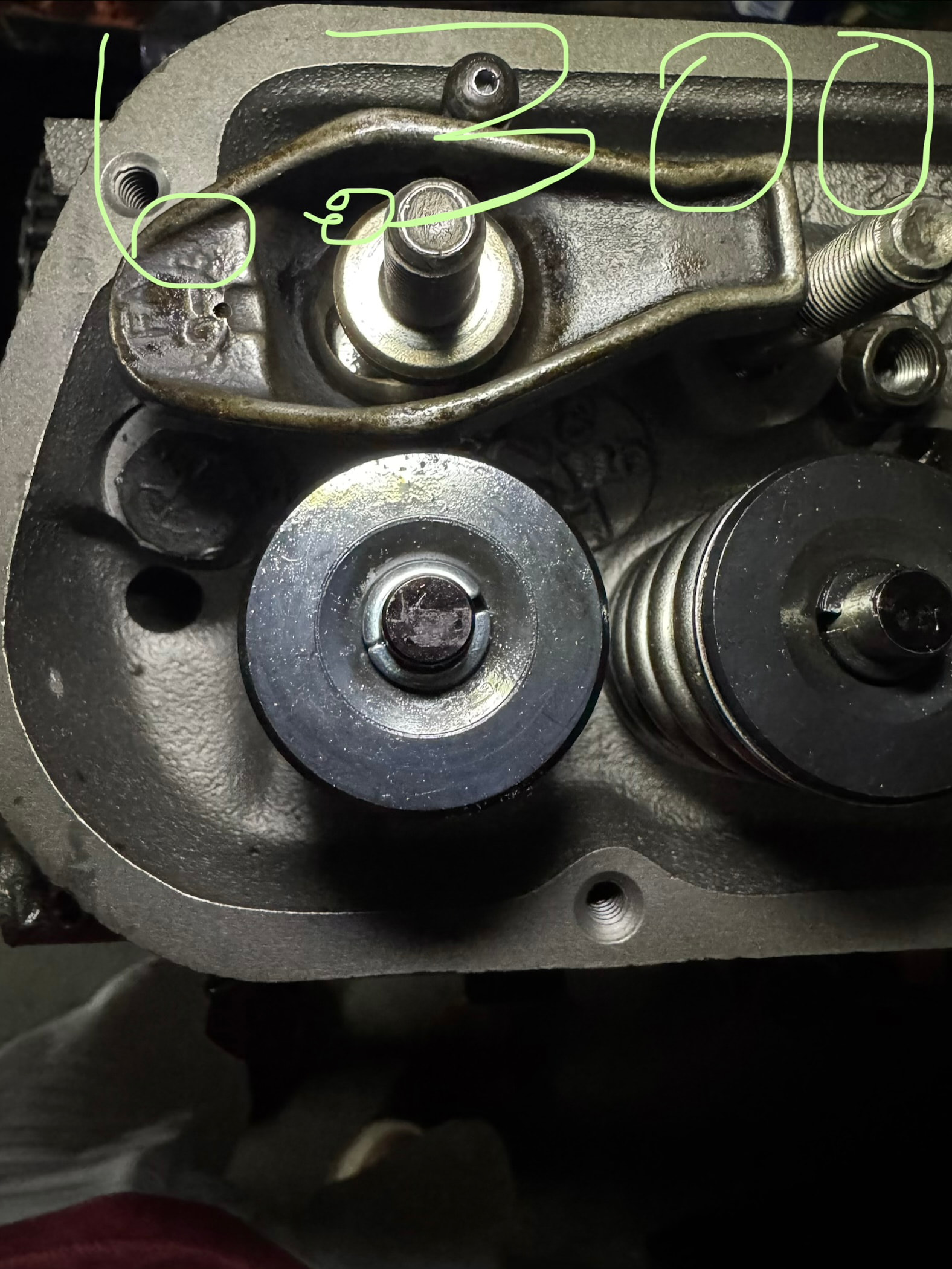

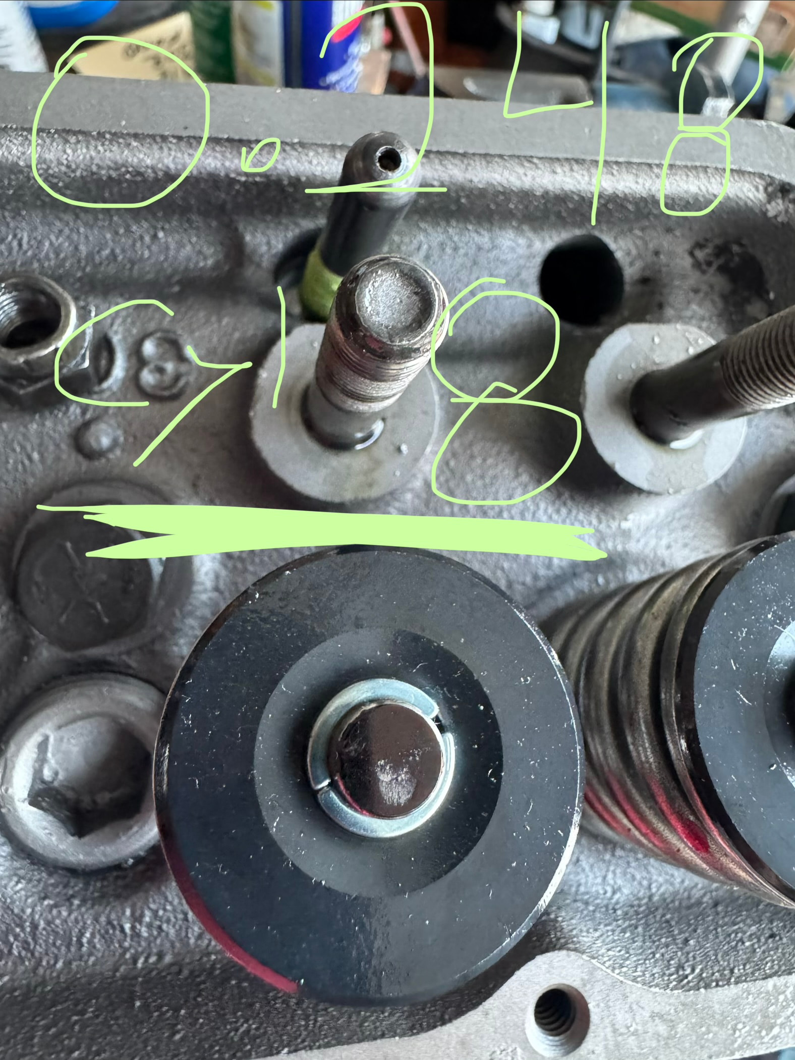

Thanks for the responses, folks. I should have added that I am using my stock rockers. I did not know that the contact patch on the valve is a bigger surface area due to its more sloped patch. Here are some pictures.
I got the numbers wrong in some of the photos; all lengths are 6 inches, plus several thousandths. I tried 6.300, 6.248 (85 FORD 302 Hydraulic roller height), and 6.270, which is a size my engine shop gave me. To me, it seems like the patch is hitting the outside of the valve stem, so my thinking is I should go with the 85 Ford height of 6.248. What do you all think?
Lay a straight edge across the top of the valve stems. See if the tips are all the same height. If they are different heights, you might need 16 different length push rods. Or, if none of the patterns go off the edge of the valve, find the pattern best centered and order a set that length. With the adjustable rockers, you can find zero lash and add a 1/4 turn of preload. It will be fine.
