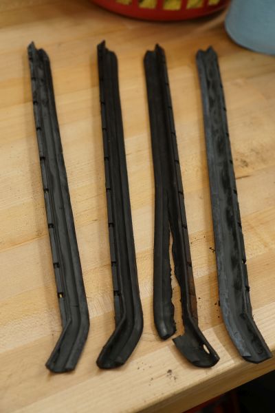

A lot more wind noise than last year found me fixing the weather stripping on my 1/4 windows. Got the new pieces from WCCC but was kind of dreading doing this on vehicle.

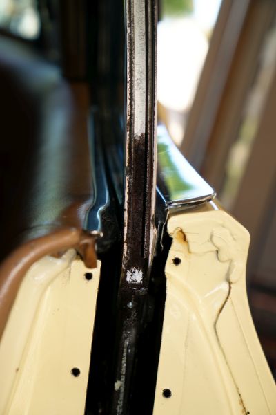

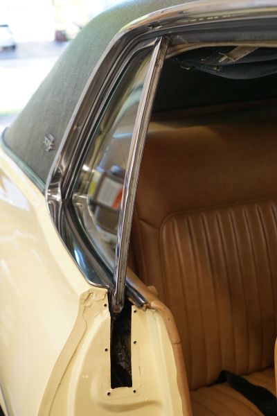

I drizzled some WD-40 in the gaps between the rubber and metal frame. Worked it in to make things loose. Driver side took some elbow grease but came out with a little prying etc… The screw was a breeze.
Just a little rust.

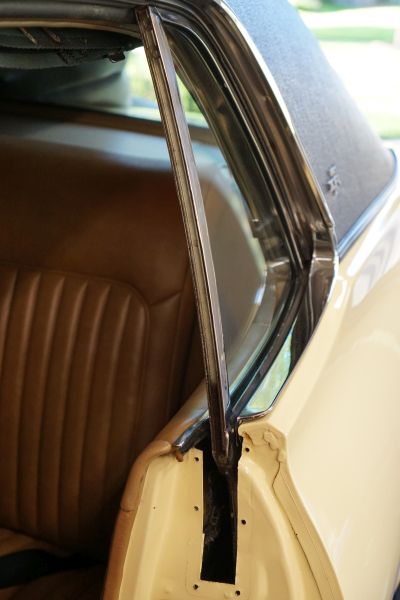

The passenger side retaining screw was the worst. Not cooperative whatsoever. “Drill baby Drill”!
