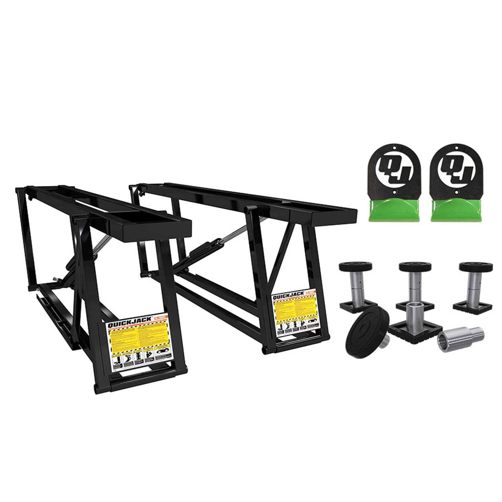

I think this is what he is looking at.
QuickJack 5175360 QuickJack 7000TL Car Lift Bundles | Summit Racing
No, I do not know anything about them.
I bought a quick jack years ago, luv it! But double check the manual, IIRC you should only lift the car from the floor, not already suspended in the air on jack stands. This may have changed over the years
Yep, this is what I was looking for. Trying to keep it on the cheap side. Did not want to spend 2k.

Two good friends have the Quick Jack.
It works very well. Lifts the car about 30” from the floor and is very stable.
To the negative:
  • The jacks are large, and hard to store when not in use. My friends bought hooks to hang the jacks on the wall.
  • The jacks and pump unit are heavy
  • The jacks do block access from the sides, so you need to slide under the car from either end
  • The hydraulic hoses can get in the way
  • One friend reported leaks from the hose quick-disconnects
  • On some flimsy cars (eg. Fox Mustangs, unit body ragtops) the body still flexes when on the Quick Jack, making the doors hard to open or close. This can also happen on two-post lifts and jack stands.
  • They are relatively expensive, unless you can find them used (not hard to do)

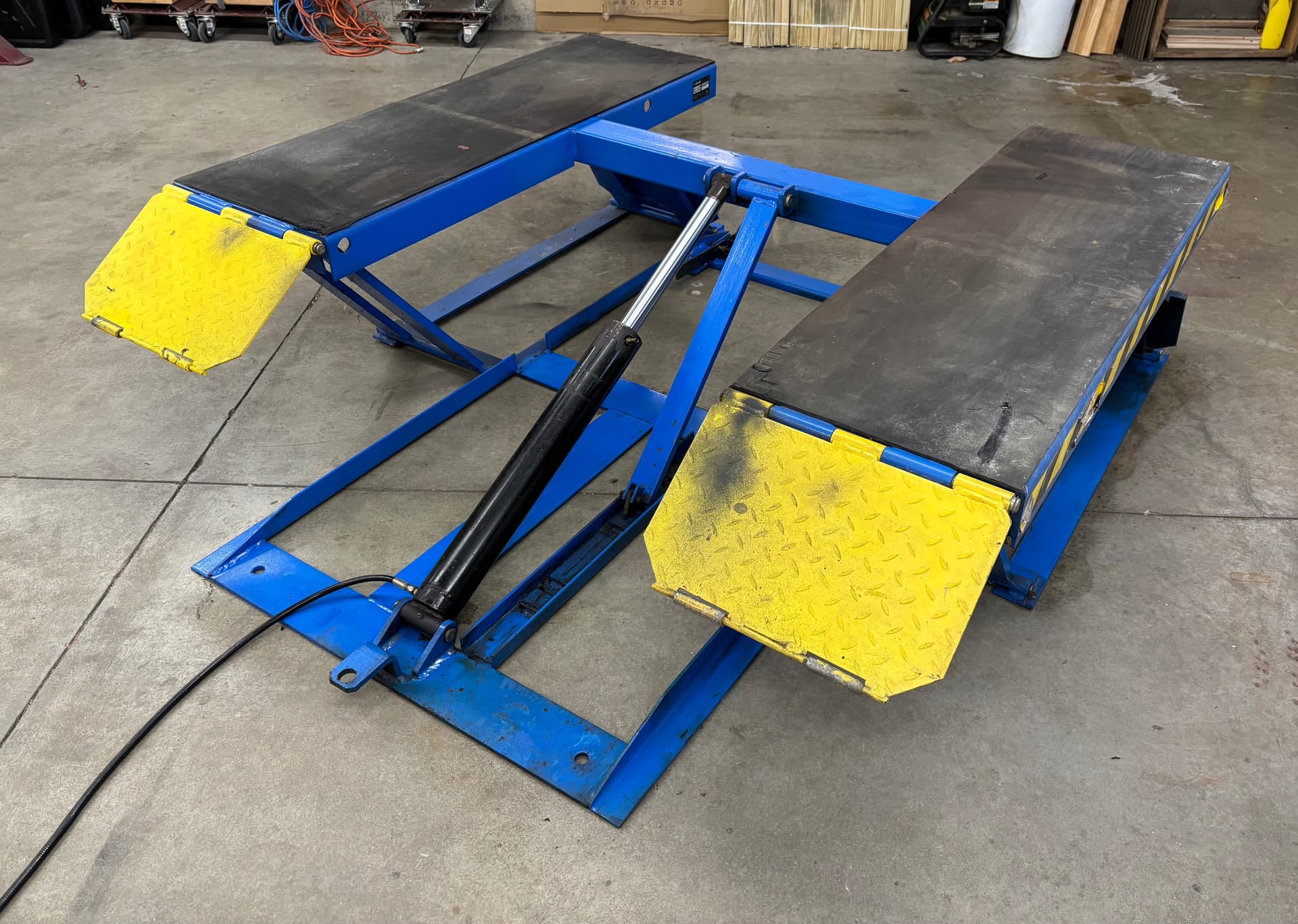

I owned one, however a much cheaper model than the one you showed. The more expensive model seems to have better under car access than mine.

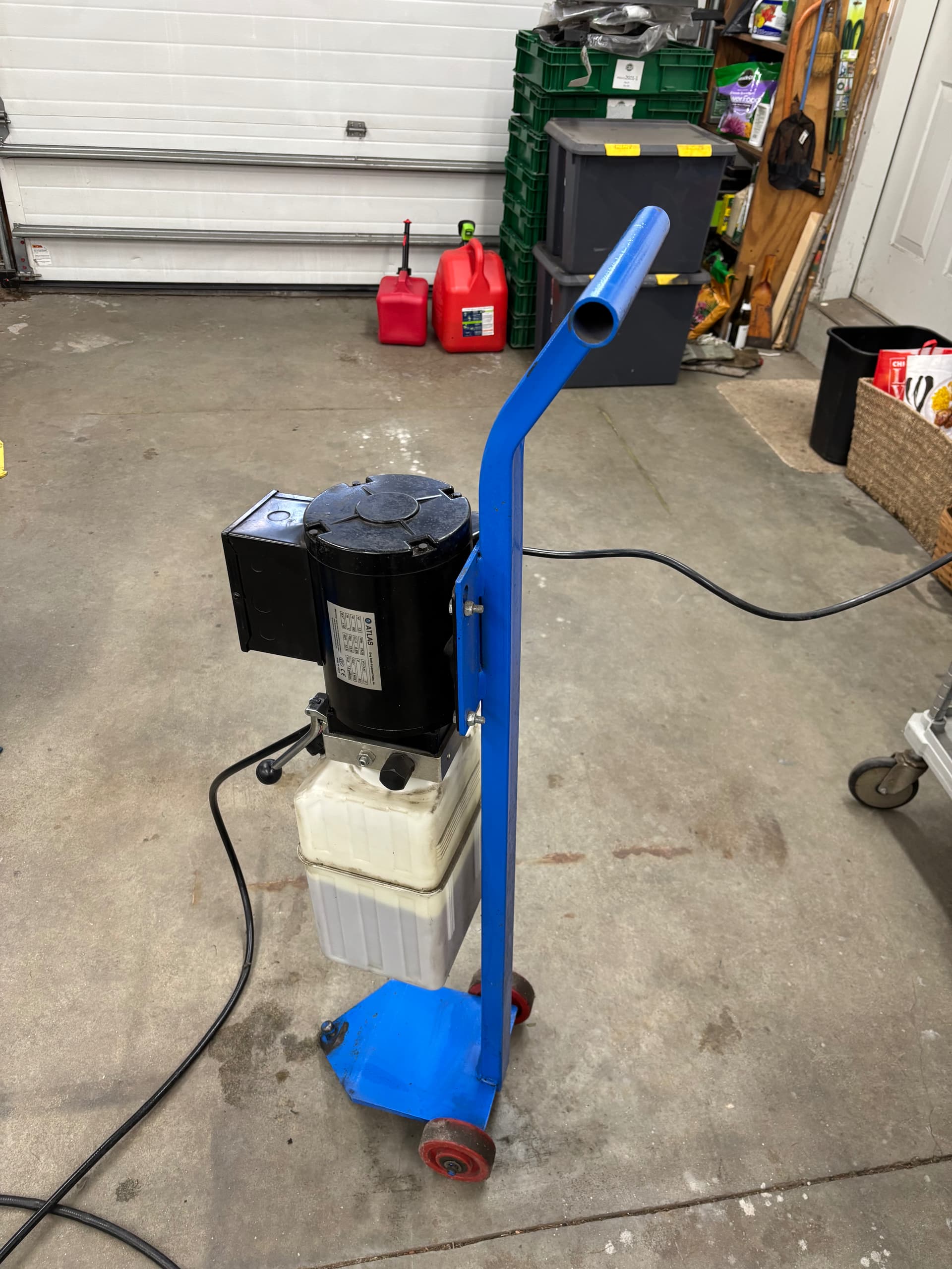

Atlas lifts work well and are very well built. You can move it around - with a lot of effort. They are HEAVY.
It is just fine for oil changes, tire service, brakes. BUT….
It is ABSOLUTELY USELESS for clutch, transmission, fuel lines, exhaust, driveshaft or pretty much everything under-car related. The pump mechanism is bulky, top-heavy and the hose tangles easily and is a real nuisance. When not in use, it takes up an entire shop bay. You can park on top of it, but that’s inconvenient too. A hassle actually.
You will quickly come to hate it - due to these significant limitations.

The model I showed has the cylinders under the ramps and leaves plenty of room for undercar work. They’re fairly simple to move assuming one has smooth concrete. In my case, it would stay in place the majority of time, works great for most things I do (detailing, brakes, oil, etc.) and driving over it doesn’t present any problems for me. All of these lifts (2 post, 4 post, scissor, etc.) have their unique pros/cons, so it it depends on the individual’s needs to determine whats best.

I looked at the specs for that Atlas lift. Much better than my old one.
We were terribly disappointed with the Atlas model we owned, but yours would be a lot more practical!
